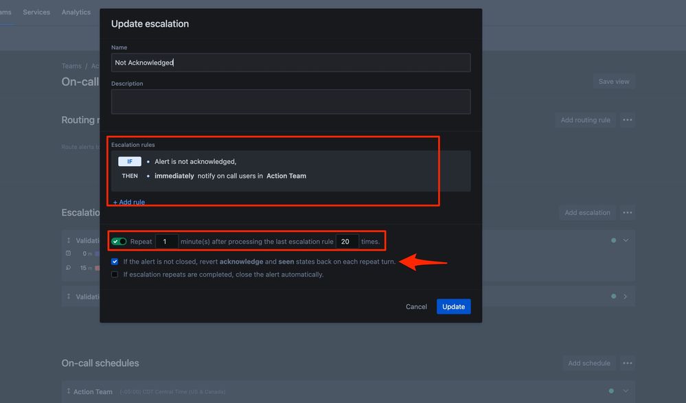

To have alerts repeat notifications to On-Call if it has not been acknowledged by a certain time, it would be best to utilize the Repeat function on Escalation policies, since you can set the steps there specifically to process if it hasn't been Ack'd. So you might have something like this:
Where notifications are sent out to On-Call users if the alert has not been acknowledged, and will be repeated if it hasn't been fulfilled after a certain amount of time. There is also an option there to revert Acks and Seen statuses if it hasn't been closed for a certain amount of time. The Snooze function could work, but the issue there is if the On-Call user has Seen the alert at least; this functions as a tacit Ack on the alert, so they wouldn't be sent additional notifications following that, so Snooze could work if they don't look at the alert at all, but the Repeat function on the Escalation policy might be better since that will repeat the notifications, and reset if they have Seen it, but didn't take action.

@Thomas Raynal - this didnt work for me , i dont want to change the ack back to unack i just want to refresh the seen state?
@Daniel Hardaker We don't have an option to reset just the 'seen' state right now, but we have a feature request to disable this: https://jira.atlassian.com/browse/OPSGENIE-36
