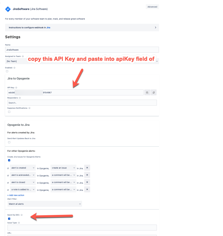

Hi @Oleksandr K_ ,
This is usually an issue with the API Key you put into the config.json file for OEC. This apiKey is what allows the OEC service to sync up with the queue. This apiKey should be the api key from the integration you are using with OEC. So if you're using OEC to integrate with Jira for example, you would paste the apiKey from your Jira integration into the apiKey field of the config.json file for OEC, and make sure "send via OEC" is checked off on your Jira integration.
e.g.
2022-02-02_15-27-17.png Hope that helps!
