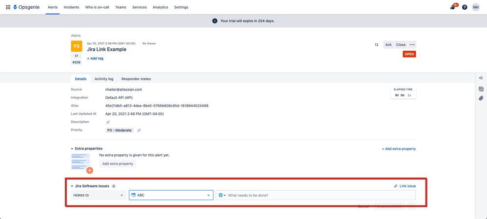

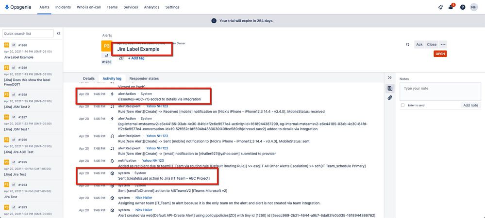

2) If a Jira issue is created from an Opsgenie alert through an outgoing Jira integration, the label 'FromOG' will appear on the issue:
While alerts that create issues through linking will not show the 'FromOG' label:

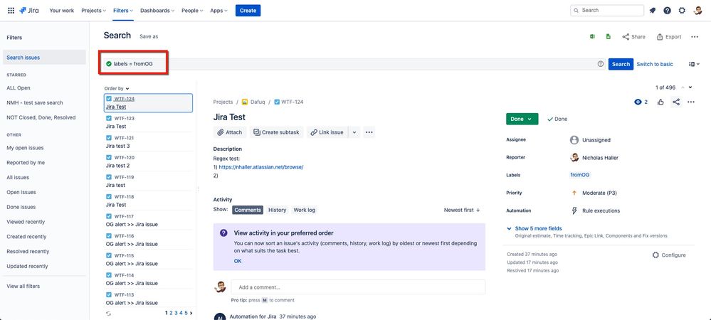

3) I would suggest using the JQL labels = fromOG to search for issues created by Opsgenie. Again - this will pull any with that label that were created through the Jira integration(s):

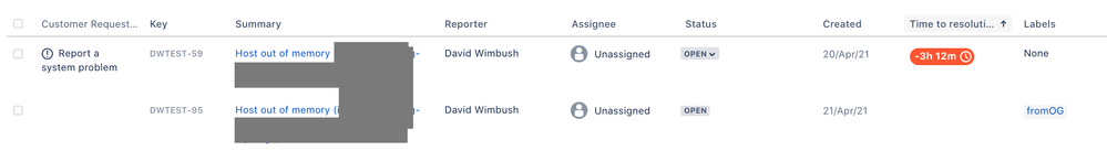

Regarding Point 2) I have seen issue in my linked JSM project that have been generated by OpsGenie but do not include the label 'From OG' (See attached).
Is there something else I'm missing here? I've compared the logs and alert detail from the ones with and without the labels and as far as I can tell, there is no difference in configuration.

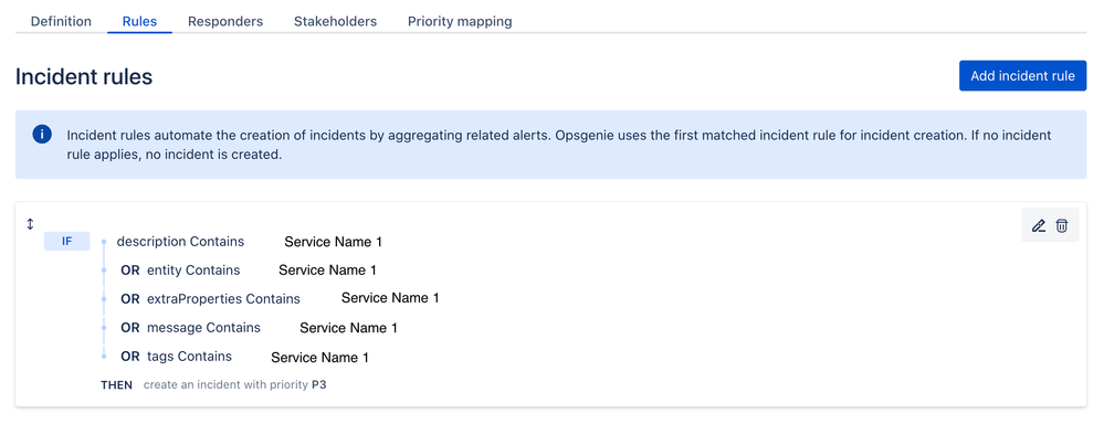

On a seperate topic, I can't seem to get OpsGenie to create incidents from Alerts. I've configured this within the Service Rules (I tried matching alert content on a number of fields), however, no Incidents are created.
Service Rules:
When an alert comes through, that references 'Service Name 1', no Incident is created. Any ideas why this might be the case?

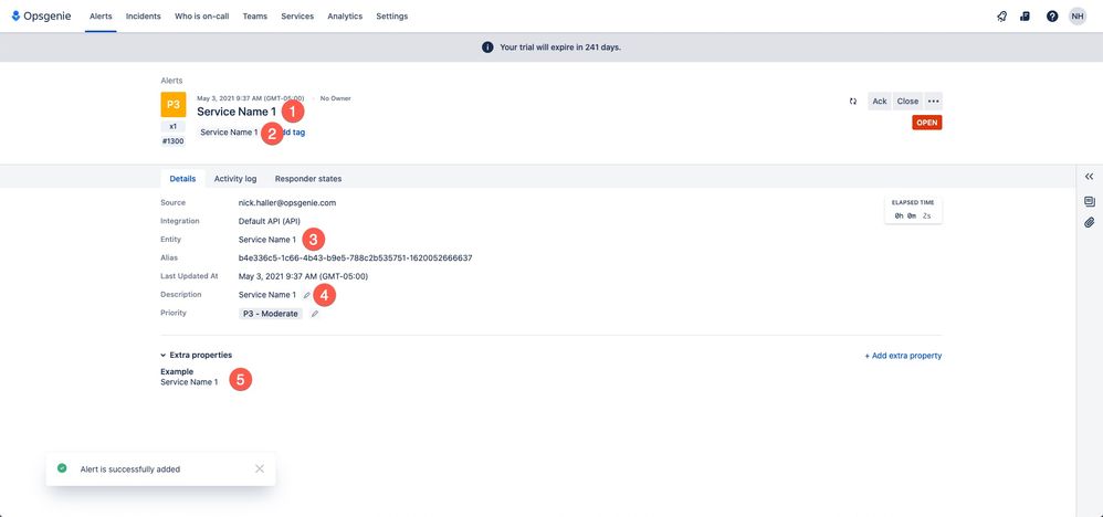

As for the Incident Rules query - those conditions need to match one or more of the alert fields AFTER it's created / the data parses into those fields. So you would have to have "Service Name 1" included in one of these alert fields for one of those conditions to match:
If the alert is matching on one of those conditions, it could be associating with an open existing incident as well: https://support.atlassian.com/opsgenie/docs/associate-an-alert-with-an-incident/
If it's associated with the incident, there should be an option to click into the incident, or check if it's associated:
