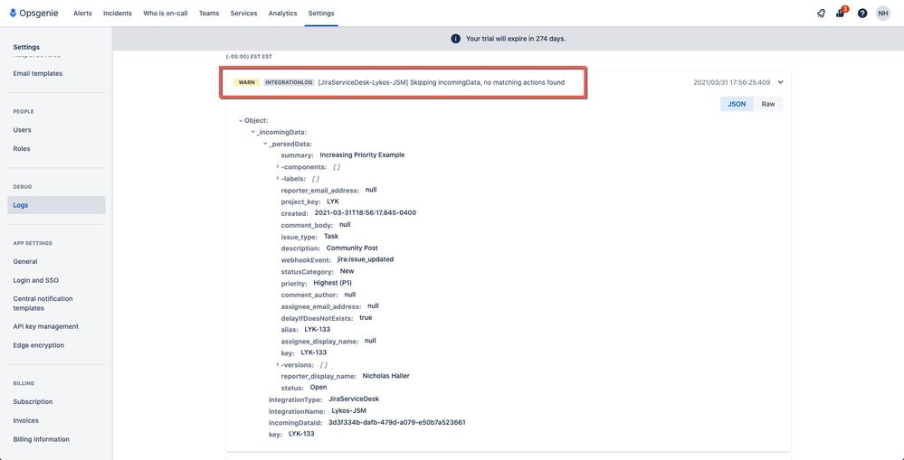

Although you have a webhook configured to send updates to Opsgenie, my guess is your JSM integration does not have a Create Alert action filtering on the updates.
If you check your logs, I'd assume you might see some like the one below: Skipping incomingData, no matching actions found
By default, the integration's Create Alert actions trigger when new issues are created.

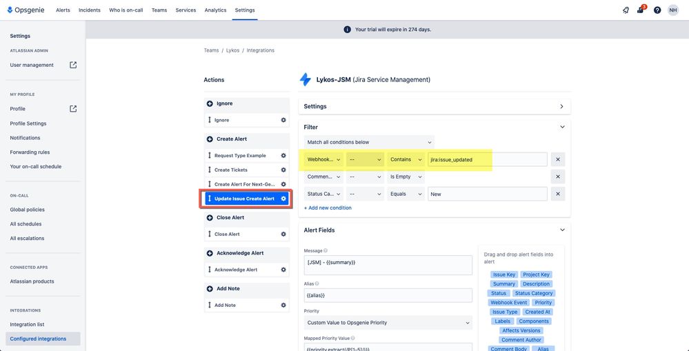

Along with these, you'd also need to filter on the issues being updated, and have those requests create alerts as well. That action and filter might look something like this:
^ This action's filter is configured to create alerts when the webhook event contains jira:issue_updated, which is shown in my first screenshot / log when the priority was increased on the issue.

I do get the same log info mentioned in the screen shot. We are waiting on our Atlassian rep to get a quote on upgrading JSM to the Pro version. Currently we are on JSM standard and only have the barley functional Opsgenie integration.
Based on the 2nd screen shot I assume we would need to be on JSM Pro in order to get issue updates to create an alert, is that correct?

If you do not see the Advanced tab of the integration located in the top right of the UI when viewing the integration, then it's a restriction with your plan.
Sounds like you are on the JSM Standard plan which is equal to the Opsgenie Essentials plan.
You'd need to upgrade to at least JSM Premium ~ Opsgenie Enterprise.
