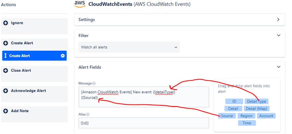

From the message field in OpsGenie I want to grab the arn and place it into the alias field. I've tried using string processing and regex methods to extract the arn but nothing seems to be working. Please see the attached image for the regex method I am using.
I'm assuming that my regex is incorrect but could anyone advise where or even suggest an alternative way to extract the arn?

Tried the above and unfortunately it is still not placing the arn in the alias field. Whenever an alert is created it is still placing a random string as the alias instead of the arn which I believe is due to the fact that the string processing methods we are using above did not find a match and as a result are returning a None value to the field.
Fiddled around with your response to see if I could get anything to appear in the alias field but unfortunately nothing was working.

Can you please post screenshots of the integration settings as well as the exact message you're processing and the string processing code you are using?
