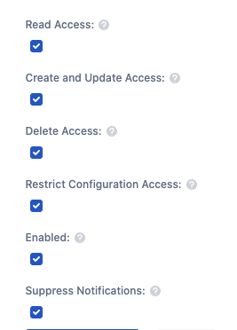

I was using a test API key in "Suppress Notifications" mode for my tests detailed below. But my production service which already uses roughly the same code with a non-"Suppress Notifications" API key could attach tags to alerts as expected.  This is probably a bug on OpsGenie side.

I just tested this with my own account and found suppressing the integration itself was not enough to reproduce this. I used cURL to send the request, but payloads with details and tags still made it into the alert:
curl -X POST 'https://api.opsgenie.com/v2/alerts' -d '{"message":"test","details":{"host_name":"localhost","host_alias":"hostname"}, "tags":["Tag1"]}' -H 'Authorization: GenieKey XXXXXX' -H 'Content-type: application/json'
Have you modified the API integration at all from default? This might be a better issue to resolve by reaching out to our support team directly.

Hmm I created a new key and switched keys from the one I created back in Apr 2019 to it, then the problem magically disappeared.
The same test script, two different keys with the same (default) permissions + "Suppress" mode, different results reproducibly. This must be a bug on your side.
