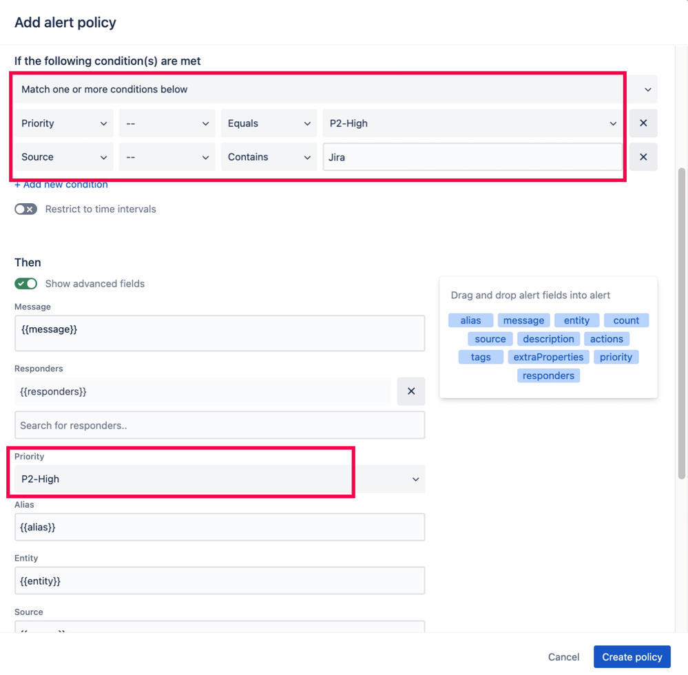

The alternative would be to use a policy to map the priority, rather than the advanced settings on the integration. You would need to create a policy for each priority and add the filter of "source contains: Jira"
Here is an example:

I apologize, I thought team-based policies were available on all plans but after checking the documentation it appears that they are also only available on the Standard and Enterprise plans. With that being the case, I believe there is no way to map priorities between Jira and Opsgenie on the Essentials plan.
