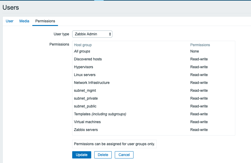

We have seen this issue come up in the past and it has been due to permissions for the opsgenie user inside the Zabbix interface. We suggest ensuring the user is a Zabbix admin and the Zabbix admin user type does need to have the ability to execute actions on the host.
We hope this helps!

My user have all of permissions but still doesn't work. I try with Java 8 and it looks good.
Thanks for your time
