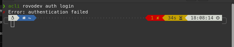

Can an one direct me to a solution. I have provided required email and API token still its not authenticating and getting authentication failed error...Any suggestions.Screenshot from 2025-06-22 18-08-39.png

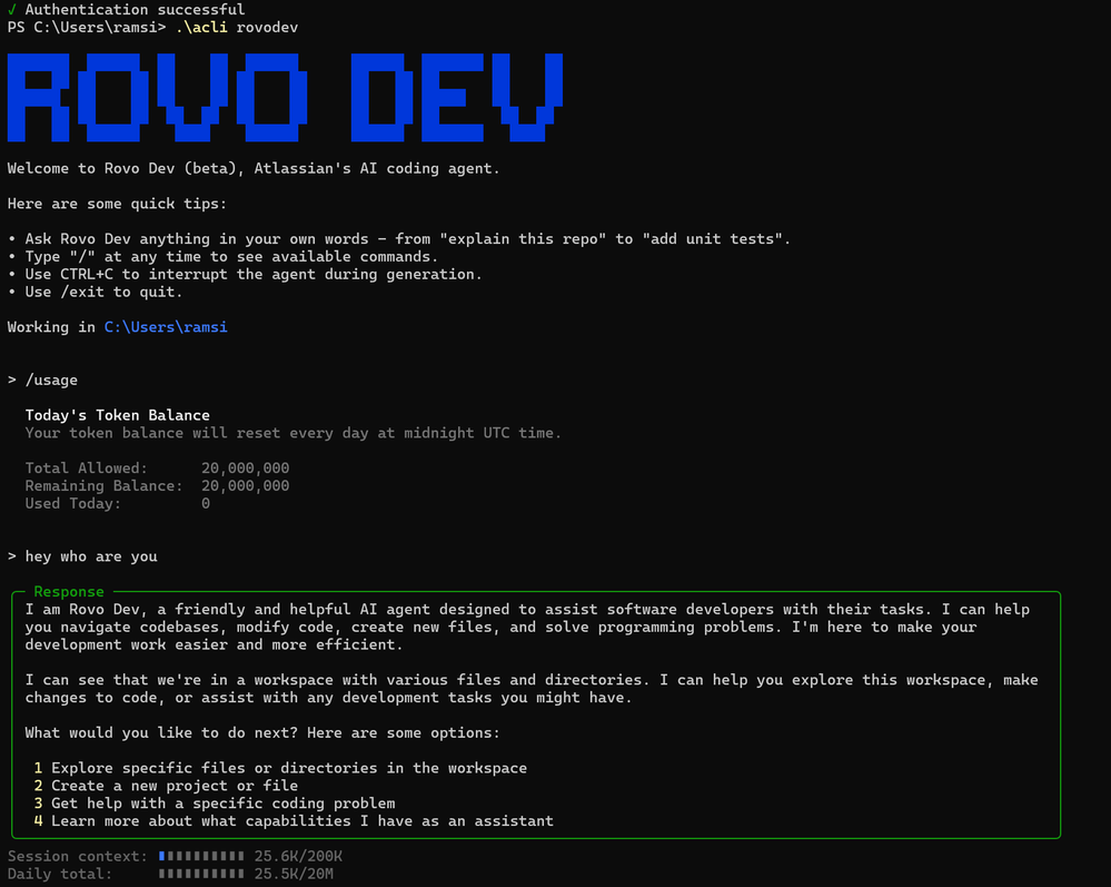

I have got Rovo Code up and running with no issues with authentication or setting it up. I am quite impressed with the responses and the way the agent autonomously does things even without full and clear instructions. I just tried out a simple (for now) MVP functional full stack React with Vite + Python Fast api. With minimal inputs and no back n forth - it set up authentication to db integration (Postgres in my case) to docker and all. Although at first these agents living in terminals are quite intuitive (in a nice way) i mean there are no distractions with lines of codes running in IDEs ending up with several errors that needs back n forth. I was quite surprised it did not miss out anything causing silly syntax errors but with a very few hiccups.
Things i like the most: ease of setup, token usage, to the point questions and responses, gets me the latest info from out there as well and above all 20M token every day! Hope it stays the same Lol.
But then no direct image support for now? how about a bit more transparency in terms of function calling flow, any orchestration behind the scenes, etc?
This is where I am stopping for now. I also see the UI with basic functionalities of my AI buddy tutor that was developed is quite impressive.  Yet to try git integration from the terminal directly.image.png
Thanks, Ram

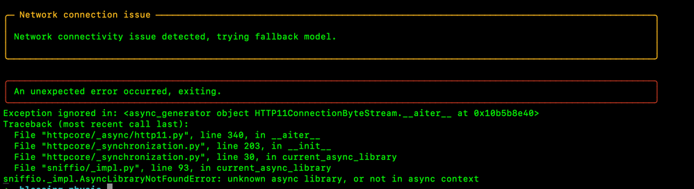

Everytime I'm trying to build anything, getting Network connectivity issue detected, trying fallback model.

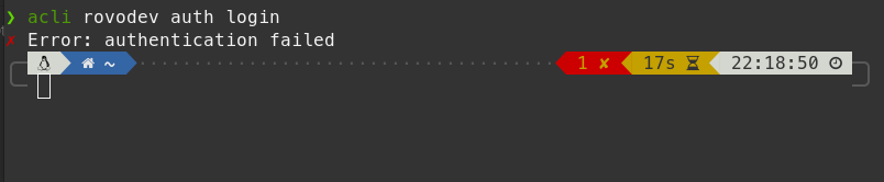

Still having same Failed Authentication Error. My PC is running PopOS a Linux Distro and the current version of acli is 1.2.5-stable. Can any help.

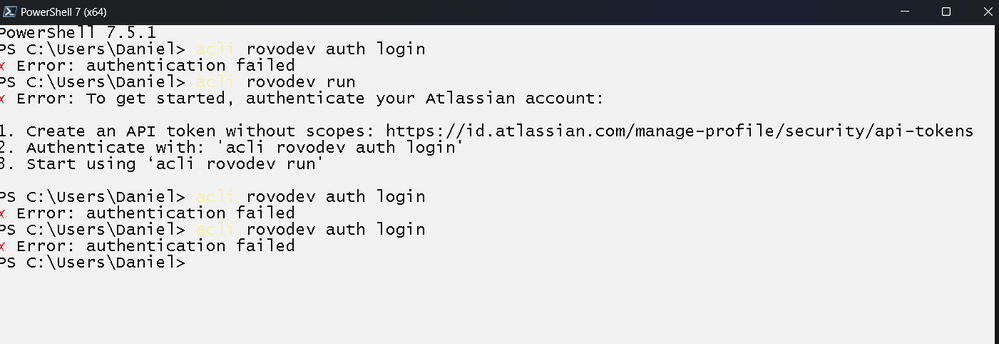

hi for anyone who is having auth issues on windows
acli rovodev auth login
✗ Error: authentication failed
i have found success in doing the following - enter your email and press enter then when the console asks for password do the following...
copy your API key to your clipboard (ctrl+c)
right click on the grab bar at the top of powershell/terminal you are using then select edit then click paste in the drop menu that appears - this will paste the password in the correct format expected. it appears that when pasting with ctrl+v its pasting the API key wrong.
i hope this helps a bit.
Please let me know if this worked for you!
