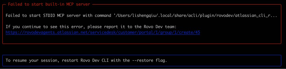

李圣秋
June 24, 2025
Failed to start built-in MCP server after running `acli rovodev run`。What's the problem?
