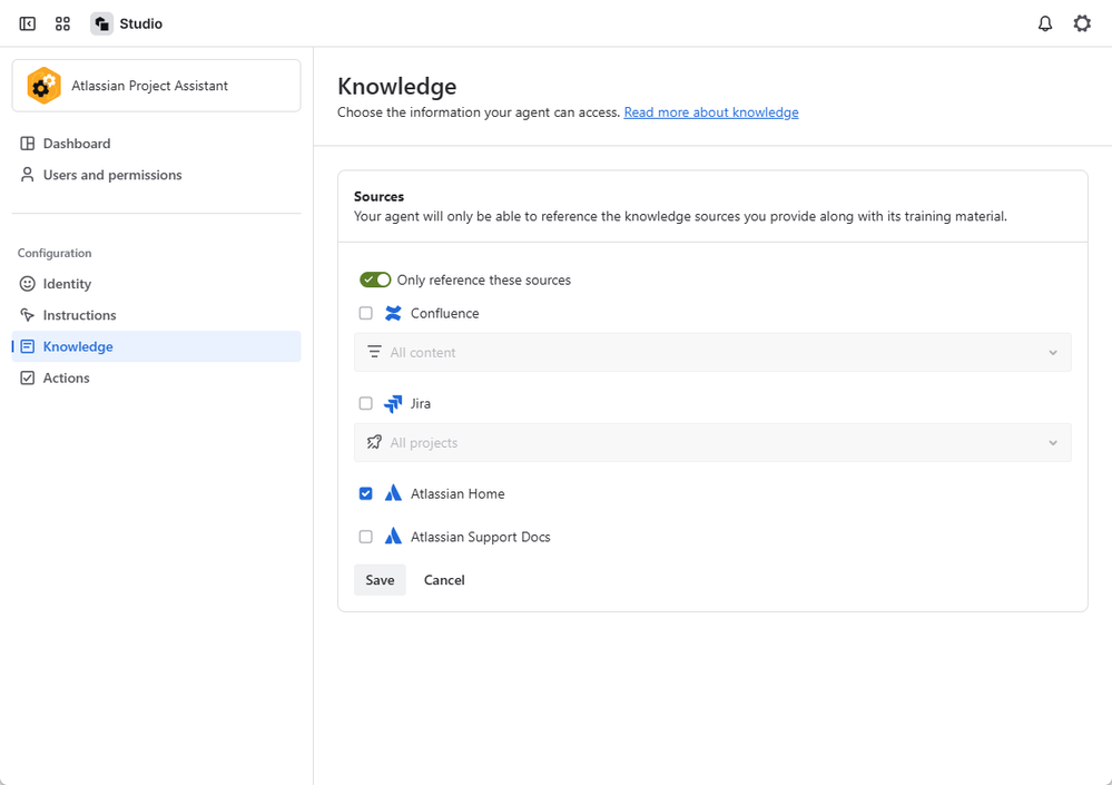

I've just tested this and managed to get the agent to get me the desired info from Atlassian Home (ex. Atlas) projects. Although I had to give the agent a specific link to a project, e.g. https://home.atlassian.com/o/<org-id>/s/<cloud-id>/project/<key>/updates 👈
Also, I've specified that it only looks at Atlassian Home as the source

Now, even as I added this general link to projects, initially it said that it couldn't find the project named ABC, which I mentioned during initial input/when starting the conversation.
So, I've used a direct link such as https://home.atlassian.com/o/<org-id>/s/<site-id>/project/<proj-key>/updates in the chat, and that seems to work.
Maybe you could add that direct link in the instructions, but I haven't tried that 👀

Great question, @Stefanie Lang! Rovo can support trend analysis of Atlas project updates, but for best results, give the agent a direct link to the project’s update page and limit its knowledge source to Atlassian Home. Results may vary by project—longer, detailed updates return better summaries. Invite Rovo to analyze based on goals and linked work, and consider adjusting prompts if results seem too generic.
