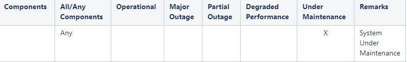

These are the results we got different as compared to atlassian support page.
For 2 or more components
If all components have a status of 'Major Outage', top-level status will read 'Partial System Outage'
If all components have a status of 'Partial Outage', top-level status will read 'Minor Service Outage'
If any components have a status of 'Partial Outage', top-level status will read 'Partial System Outage'
If all components have a status of 'Degraded Performance', top-level status will read 'Partially Degraded Service'

Hi Jesse,
Thank you for your response but The results that we are getting for top level status are quite different than what is in atlassian support page.
I am sharing the results that we got in our testing in below screenshots.
pageId - rh5v0ryp1g42
componentId - y9vryrmmcvjl, wbc4h94hphc5, 41z7gqsrv2hh
Can you please confirm on this asap?
Hello again,
I am not getting the same results unfortunately. When you have 2 or more components, all will mean all. If I have 5 components, all 5 need to be in the same outage level to show the correct results. The table that you have presented seems to be missing that perhaps? I have gone through the exercise again and I am getting the same results as what is on the documentation excluding the one I mentioned from before. If you want, I have created a free page at freeplantesting1.statuspage.io and you can see there that all three components are showing major outage and the top level is showing the same.
