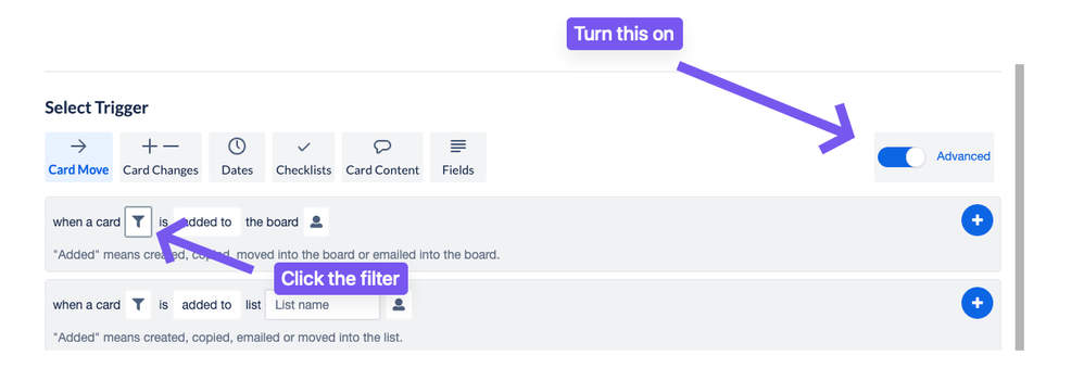

@Kirsty Prasad  You can set more filters for rules.
Make sure you have the Advanced filter toggle on and then choose the filter when setting up the rule:

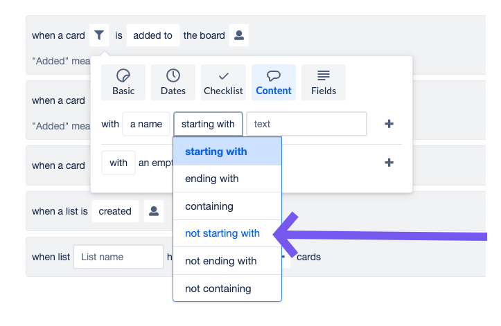

And then inside the filter modal, click content:
and then you can choose to filter by cards with a name not starting with or not containing your ---.

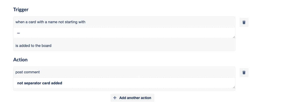

Full rule looks like this:
