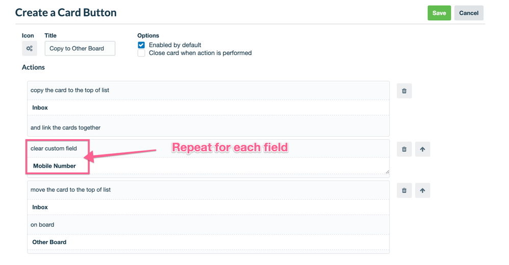

But the way to avoid polluting them in the first place is to use an automation to move cards from one board to another when you're using custom fields, that first copies the card, then clears all the custom field values on the card, optionally links the 2 cards together and moves the copy to the target board/list.
You could do this with Butler for example with a card button:
