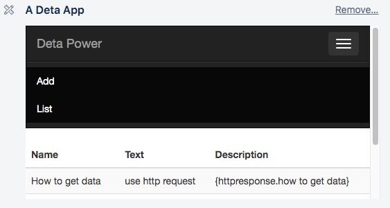

October 2, 2022
@Deb Breen
This is something I am working on. It is inspired by your request for card specific custom fields. The key is really the fact that I can use the same app as a server to get the data back and the variables in Trello automation.
@Allen -Amazing PowerUps-
If you can, what are you using for ui. Currently, I can only use jinja2 templates which is not pretty.
The output is actual {httpresponse} which means you can use it in Trello Automation using {httpresponse.<some name>} to get the value e.g.{httpresponse.Card Specific CF } will give you "You asked for it".
Screen Shot 2022-10-05 at 3.46.42 PM.jpgScreen Shot 2022-10-05 at 3.46.31 PM.jpgScreen Shot 2022-10-05 at 3.46.23 PM.jpg
