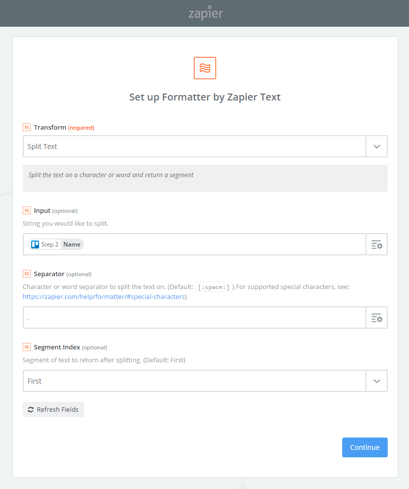

Click the plus sign to add a step at the end, and then find the Zapier Text Formatter tool. Then set it up like this:
This splits the Trello card name before the period in the file extension, and then only keeps what appears before it. So your card name will essentially just lose the file extension, which should make the URL behave properly.

I had no idea Zapier could do that. Thanks a lot! This worked (with the adjustment that I had to create the step before the card in Trello and then reference the card name to the created value) as a workaround and will definitely prove useful in the future.
