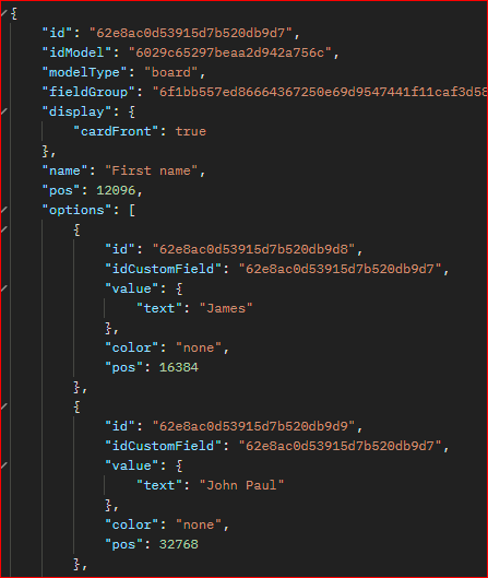

ManniStudio September 11, 2022
Hi David,
First off thank you so much for your answer. I'm facing the same Puzzle.
I went through your example and learned a lot.   I was able to complete it and get a list of all Options for my Custom field.
But how can I tell which option was selected?  The JSON doesn't reveal which option was selected by the user (that I can find).
Example:
I have custom field called: "First name", setup as a dropdown, and contains 4 options:
First Name
  James
  John Paul
  Robert
   John                 <<<<<==== Selected
If I select Option #4 "John" how do I perform a GET that tells me that this option was  selected?
User UI:
My Get call using the ID for my Custom Field "First Name":
JSON: Info on each option:
Apologies if I missed something in your example, I'm still Green with REST calls.
cheers,
Damon
Sunny Ape
September 12, 2022
Hello @ManniStudio
The answer is in the OP's original question. You need to query the Get Custom Field Items for a Card endpoint, which will tell you the IDs of any options that have been set per custom field per card.
Note. If this endpoint returns an empty set, it means no options have been set for any custom fields on that card.
For example, I have a board with custom drop-down field called 'Dropdown choices' and it has four choices (I can discover the field and its options from the Get Custom Fields for a Board endpoint).
On one particular card, that custom field has been set to the choice 'Purple option':
I lookup the custom field items for that card:
GET https://api.trello.com/1/cards/631ed7381a8cfb00e091c317/customFieldItems?key=blah&token=blah
And the response tells me:
  "id": "631ed7381a8cfb00e091c317",
  "idValue": "60ce91cf104a13124295ec0e", <-- id of the option selected
  "idCustomField": "60cd9792d094da669588de05", <-- id of the custom field
  "idModel": "62c545eaaa69773929397646",
  "modelType": "card"
So, I then just compare the ID of the option selected for that custom field for that card with the knowledge I already know about that custom field via either the Get a Custom Field endpoint or the Get Custom Fields for a Board endpoint to reverse 'translate' the option ID back to the text content for that option.
