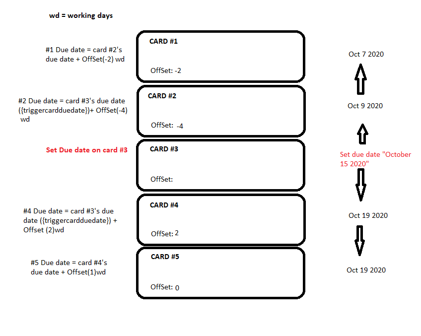

×I' trying to set the due date on card number 3 and then calculate the other cards due date from that card using a Offset number (Custom field) on each card. A due date needs to be on a weekday
Card 1 & 2 due date should earlier then card #3 so I want to use a negative Offset number
Card 4 & 5 will have the same due date and will be after card #3.
What I've tried is:
#3 is linked to #2 and #4. #2 is linked to #1. And #4 is linked to #5
The first rule's trigger is when due date is changed on #3, then foreach attachment, set my custom field (TempDue) to the trigger cards due date. set DueDate = TempDue -1 + Offset wd.
when a due date is set on a card with a name starting with "Card #3", for each card linked in the attachments, set custom field "TempDue" to "{triggercardduedate}", set custom field "TempDue" to "{{%TempDue}-1d+{{%OffSet}}wd}", and set due on the date in custom field "TempDue"
The second rule's trigger is when due date is changed on a card (if not #3), find first attachment, set TempDue to {triggercardduedate}, set DueDate = TempDue -1 + OffSet wd.
when a due date is set on a card with a name not starting with "Card #3", find the first card linked in the attachments, set custom field "TempDue" to "{triggercardduedate}", set custom field "TempDue" to "{{%TempDue}-1d+{{%OffSet}}wd}", and set due on the date in custom field "TempDue"
This works when the Offset value is positive. But can't get it to work when using a negative offset number. I've tried to set the Offset inside of parentheses but then butler can't find the date
Any tips on how to solve this one?
