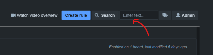

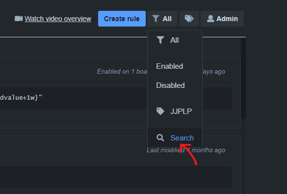

  4. Don't forget the search function in Trello (I always do but am trying to remember)
