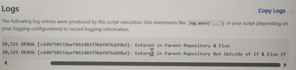

And the log says:
Entered in Parent-Repository & Else
Entered in Parent-Repository But Outside of If & Else
but it is not entering "If childIssues > 0" condition, when Parent is in Repository & Child is in Done i.e. Entered in Parent-Repository & If C>0

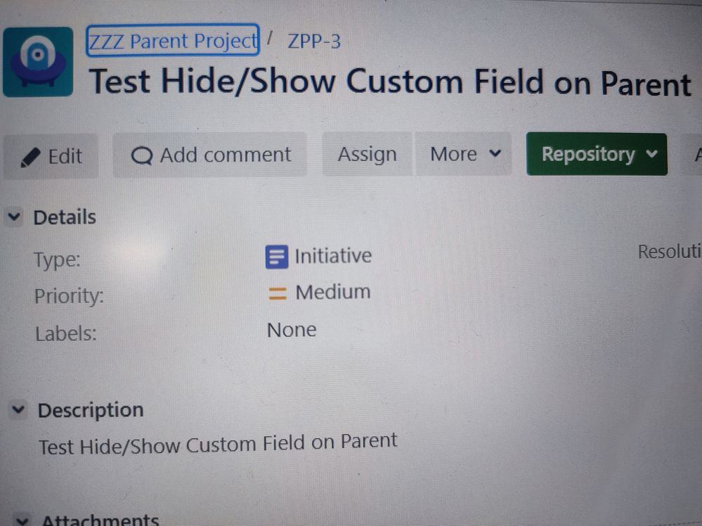

Parent in Repository

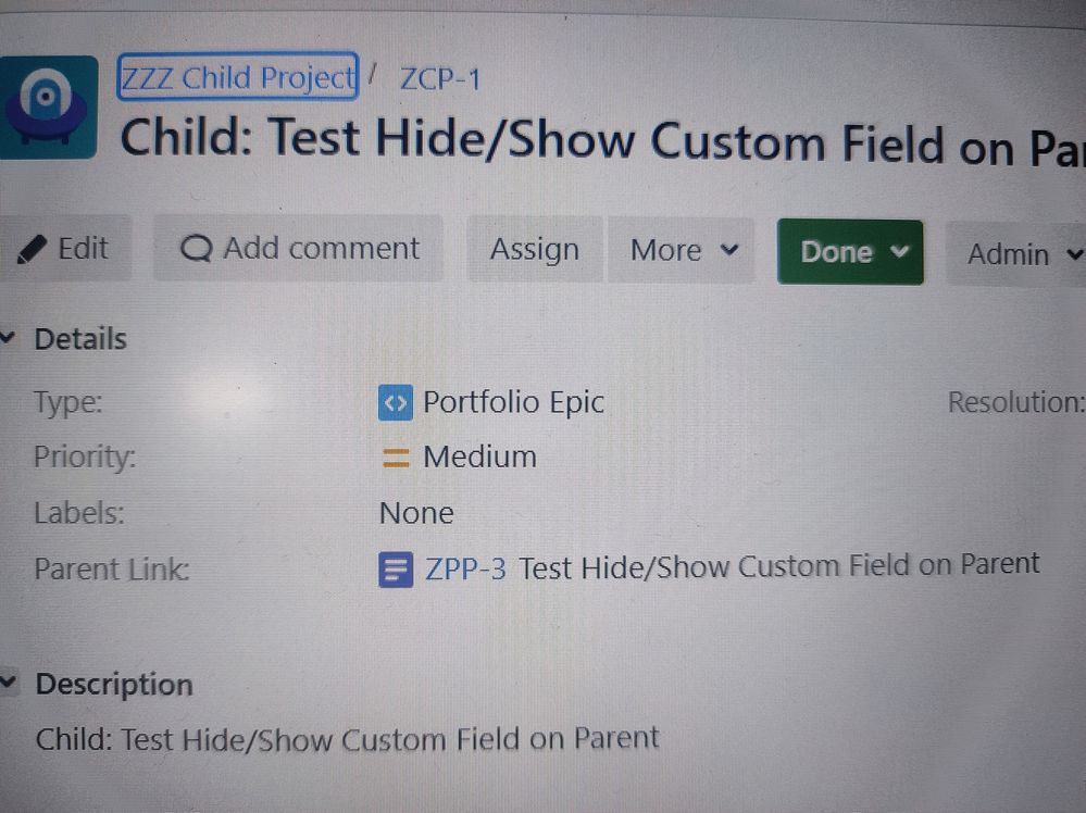

Child in Done with Parent Link

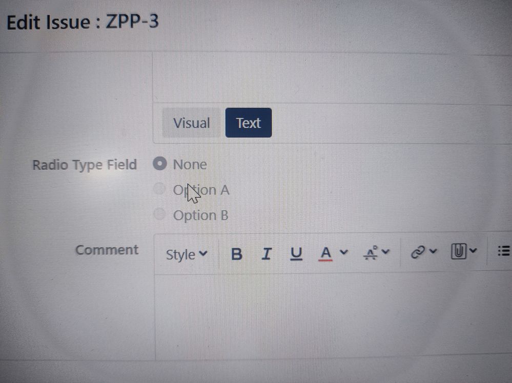

Radio field is ReadyOnly on Parent issue - instead it should be in Editable and Required on Parent issue if Parent is in Repository and Child is in Done
Log debug at this time
