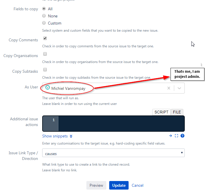

Can you include some screenshots of your configurations?
Are you positive that the last field in the form is correctly populated: Issue Link Type / Direction
If you leave that blank, no links are created between the original and cloned issue.
If that's correct but you still don't get links, make sure the "run as" user has permission to create links.

Hi Peter-Dave,
I am positive that the last field was filled out. I have also checked but there aren't even any issues being created in the target project, so there is nothing to be linked.
I am Jira Admin of our entire server at the moment (as of recently so I am not very experienced yet) and I should have all the necessary rights to move/clone/create issues. When I navigate to the relevant projects I am able to perform these actions manually so that confirms it.
Some screenshots and extra info below.
The two screenshots above show the configuration of the listener. There was a bunch of codes in the "Conditions" and "Additional issue actions" fields earlier but I scrapped all of it to be sure that these are not causing the issues.
I've only used this configuration directly in a workflow post function.

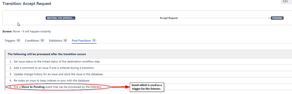

What I'm wondering right now is if this type of built-in script knows how to handle custom events (as yours clearly is). I've worked mostly with system events.
Or, the custom event is not loaded with an issue object and the built-in script doesn't have anything to act on.
You can troubleshoot that by creating a separate custom event and outputting to the log some of the objects bound to the custom event.
But if the built-in script can't work on the custom event, your best bet will be to move the config to the workflow postfunction.

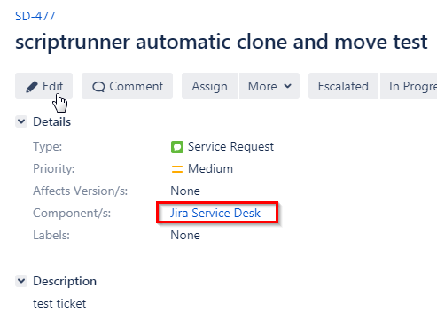

issue.components == 'Jira Service Desk'
The compared value matches the Component label set on the ticket which I used for testing perfectly. Is something else wrong with this Conditional check?
