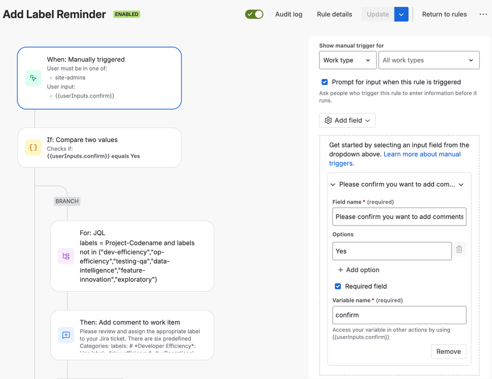

Recently a user wrote a Python script to add a comment to all issues that met certain criteria in a JQL query. But she wanted to run it as a service account.
It seemed like a more secure approach would be to instead create an Automation Rule that could be manually triggered (by a group with just this user).
The rule was simple enough, but she asked if there could be a confirmation screen because selecting an rule from the Automation menu triggers it immediately. Additionally, the menu does not close, meaning there's a real possibility you could accidentally run the automation twice (which happened to me while testing).

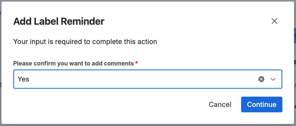

Using the feature to Prompt for input when this rule is triggered allows us to put up a nice confirmation dialogue that allows the user to choose Yes and then Submit.
We get the added benefit that the Automation menu closes when the dialogue appears.
Here's what the rule looks like. Pretty simple, but useful!

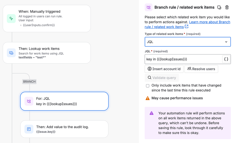

In fact I was so sure this was what was preventing my rule from updating any issues except for the one I triggered it from that met the JQL query, that I asked some Champions and @Trudy Claspill suggested I use a Lookup Issues action and then reference it in a For: JQL block with:
key in {{lookupIssues}}
Which worked as expected (pulling in all issues including the one it was triggered from).
[But this also begs the question, shouldn't it technically be {{lookupIssues.keys}}? (It appears Automation/JQL accepts sloppy variable typing, sigh. And I'm not even a programmer!! What is this, Perl!? :-)]
As it turns out  {{lookupIssues}} comes in handy for a little email "report" I sent after the comments were added, so I went with it, but because it was bugging me, I went back to just using For: JQL, making sure to leave the dupe prevention checkbox unchecked, and lo and behold it worked.

BTW, to close the loop re: the exclusion that Automation automagically adds to For: JQL branches, this was definitively proved by an error message I got when I forgot the parentheses around {{lookupIssues}} in my query:
The error I got was:
SIM-1: "(key in TEAM-4, TA-1, SIM-2, SIM-1) AND (key != SIM-1)" - Error in the JQL Query: Expecting ')' but got ','. (line 1, character 15)
Which indicates that yes, I forgot parentheses around my list of keys, but ALSO, that it is excluding SIM-1 (the trigger issue) with:
AND (key != SIM-1)
Just as you described.
For the record, the query I ended up using (which works, except for the excluded issue), is:
key in ({{lookupIssues}})
