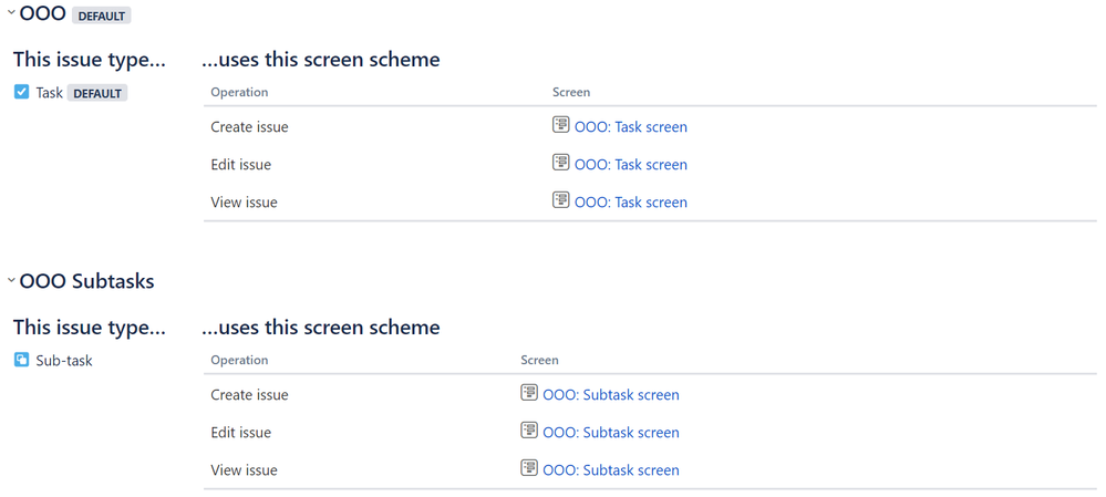

Screens / Screen Schemes / Issue type screen scheme
Before we start creating this Jira automation rule, let's modify the screens used in the Issue Type Screen Scheme assigned to the project:
  • All operations for Task have an associated screen with the fields: Summary and Assignee
  • All operations for Subtask have an associated screen with the following fields: Summary, Assignee, Start date, End date, Coverer, Related project, Options

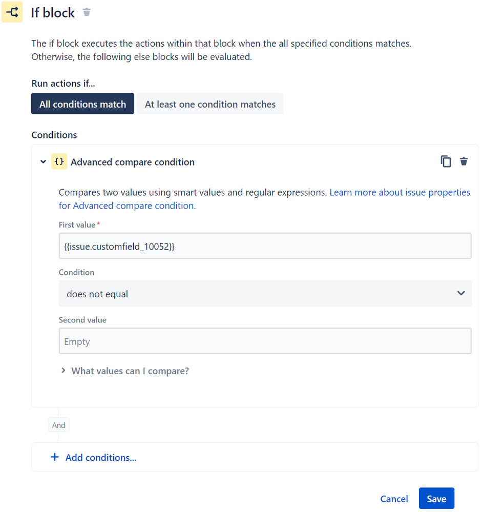

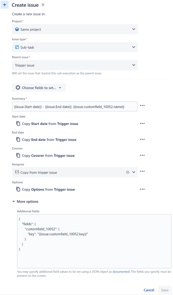

  2. Create a sub-task if the project was selected in the Related project field (field id - 10052: you can check any custom field id in the ways described here). Because the project picker field is not fully supported in some Jira Automation components  (for example they are not visible in choose field during issue creation or edit actions) we need to take care of them in a more advanced way shown below:
    1. "If" block with Advanced compare condition: {{issue.customfield_10052}} does not equal Empty
    2. Create issue action with the following configuration:

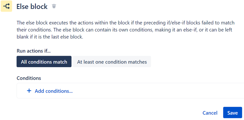

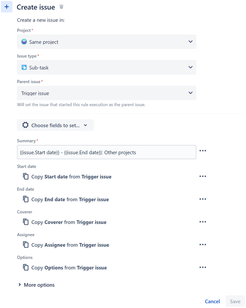

  3. Create a sub-task if the project was not selected in the Related project field
    1. "Else" block without any additional conditions

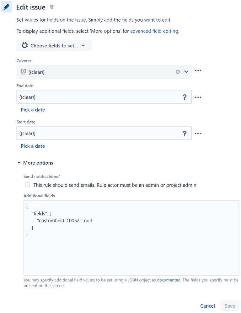

  4. Clean Task fields regardless of the Related project field using the Edit issue action:

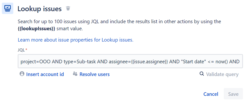

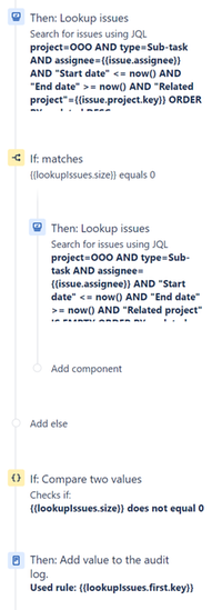

  3. To retrieve the correct Out Of Office rule we will use the following set of components:
    • Lookup issues action with configured JQL:
      project=OOO AND type=Sub-task AND assignee={{issue.assignee}} AND "Start date" <= now() AND "End date" >= now() AND "Related project"={{issue.project.key}} ORDER BY updated DESC
      to get the newest user OOO sub-task related to the current date with the current project selected in the Related project field.
    • Advanced compare condition: {{lookupIssues.size}} equals 0 - to overwrite the OOO rule in case there is no specific rule for the current project (if the previous component did not return any sub-task)
      project=OOO AND type=Sub-task AND assignee={{issue.assignee}} AND "Start date" <= now() AND "End date" >= now() AND "Related project" IS EMPTY ORDER BY updated DESC
      to get the newest user OOO sub-task related to the current date with an empty Related project field.
    • Advanced compare condition: {{lookupIssues.size}} does not equal 0 - to run the rule only if the user configured the proper OOO rule.
    • Log action: Used rule: {{lookupIssues.first.key}} - to save this information in the rule audit log for future troubleshooting purposes.

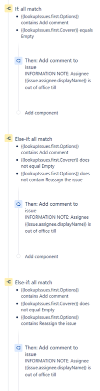

  4. Main rule components are divided into 3 sections - one for each action possible to configure in the Options field:

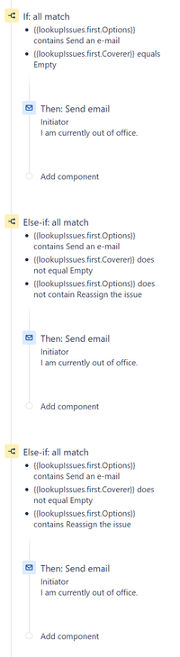

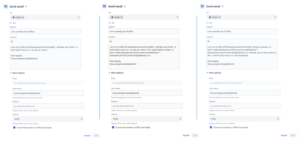

    • The first section is used to send an e-mail notification to the user who has assigned an issue to an absent user.
      As you can notice there are 3 possible outcomes with different e-mail body content:

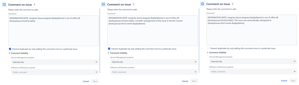

    • The next section is used to add a comment to an issue assigned to an absent user.
      As you can notice there are 3 possible outcomes with different comment content:

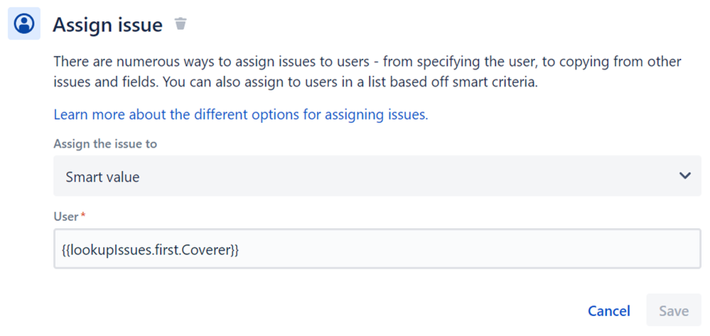

    • The last section is responsible to reassign an issue to the coverer
