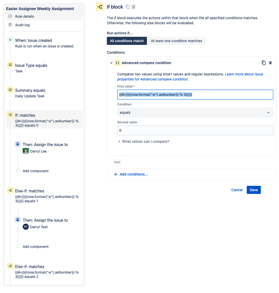

I CAN NOT get any data from the affected system.
My rule is exactly as per the image attached and taken from the the original thread, however i get the error as posted in the opening post of this thread.
Leon
July 22, 2025
Leon
July 22, 2025
my error is this:
"error rendering smart-values when executing this rule: unable to parse expression: % 3"

I have tested the exact same text provided in the referenced rule:
{{#=}}{{now.format("w").asNumber}} % 3{{/}}
Can you double check that your text matches exactly? Carefully examine it to confirm you are using curly braces everywhere except for the parentheses around "w". Make sure the curly braces are always in pairs. Double check that you don't have any extra spaces. Make sure that you have used the same upper/lower case.
If you can, take the above text and copy/paste it into your rule, then try running your rule again to see if it works.

I got it!!
You said you are "running on-premise", which I assume means you are running Jira Data Center.
The solution in the referenced post is based on Jira Cloud.
In Jira Data center the expression needs to use slightly different syntax. I tested the following in Jira Data Center 9.2.17 and it works.
{{#=}} {{now.format("w")}} % 3{{/}}
Notice the curly braces are just around the smart value, not around the entire Modulo math expression.
Also, .asNumber doesn't seem to work in Jira Data Center, but it turns out not to be necessary in this formula.
