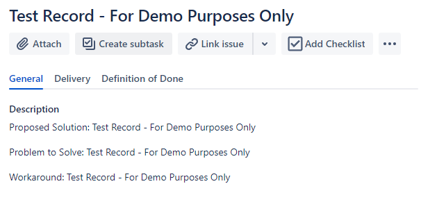

I need to be able to copy the values from 3 existing multi-line open text custom fields from one project issue record into the description field of the new issue record when the record is "moved" from it's parent project into a new one.  This is because the destination project does not contain the same custom fields, and we don't need them there.  I've read through the advanced documentation on how to do this, but still not getting the value to carry over.  Any help to get this working correctly would be greatly appreciated.  Thanks!

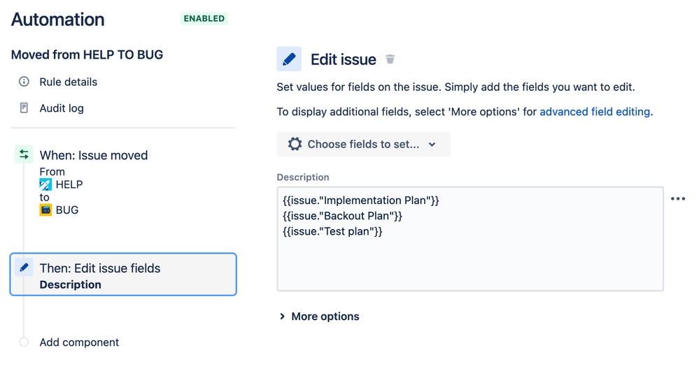

The main problem is what @Colton_Kosicek mentioned last. You don't need to use issue.parent, because that's for subtasks, etc.
To avoid confusion, instead of "parent", let's call it the original project. And because Description is a pretty standard field, you don't even need to use Advanced Field Editing where you get all into the JSON. (As much as I love that kind of stuff.)
The key thing is, when you move a ticket to a project that doesn't have the same fields visible, those field values are still there. And in Automation you can reference them like any other Smart Value for issue fields .
So then, this works just fine:
Where my multi-line fields from the original project are "Implementation Plan", "Backout Plan", and "Test plan".
Oh, and btw your rule assumes the Description in the original project is empty. If, perchance, it is not, and you don't want to overwrite it, you might want to use:
{{issue.description}}
{{issue."Implementation Plan"}}
{{issue."Backout Plan"}}
{{issue."Test plan"}}
Let me know if this works! I tested and it seems to do the trick for me.

Thanks @Darryl Lee - this is exactly what I was looking for.  It worked!
You caught that my description field was going to be blank.  That's correct, because the description field is not used in the source project, but will need to be transferred to the destination project via existing fields.
