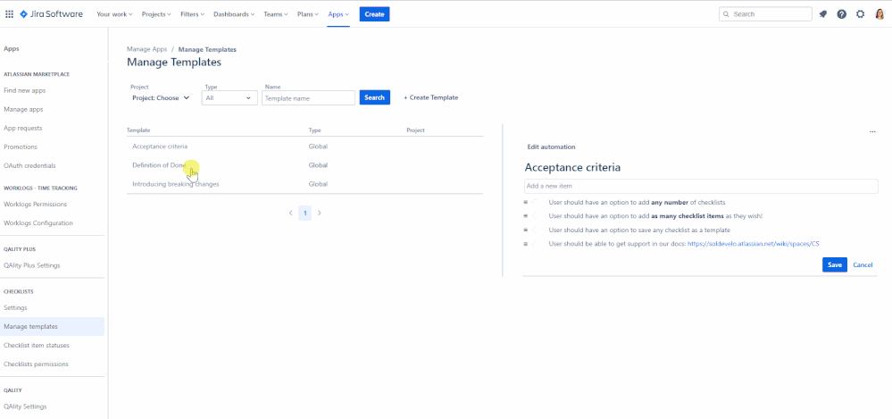

Hello @Tamara Tannenberger ,
I strongly recommend you check out our Multiple Checklist for Jira. With our app, you can create a checklists template which can be added automatically to your issues.
For example, I have a Definition of Done template, which is a global template available for the whole instance. I can automate it so that it is being added in selected projects whenever an Epic or a Task is created:

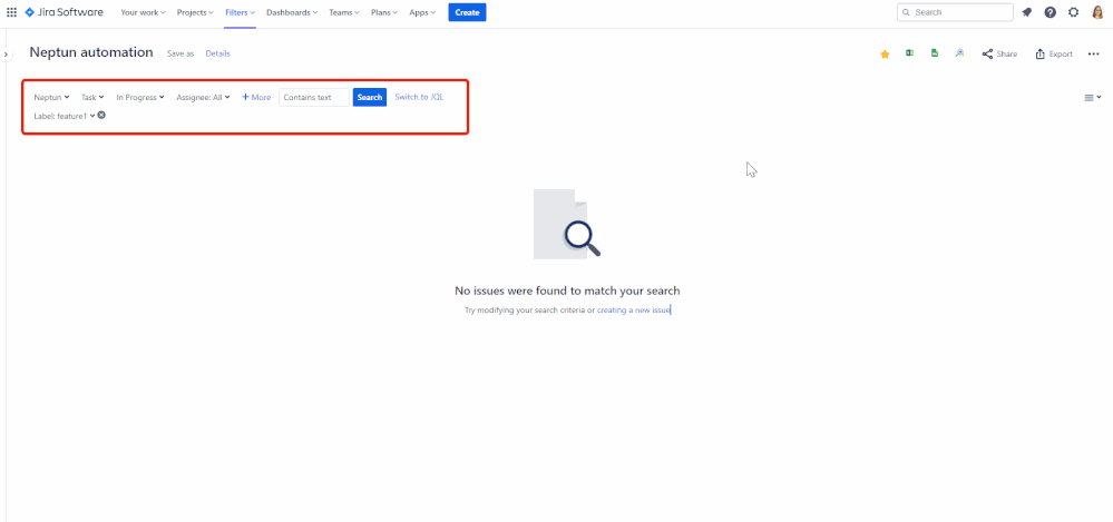

You can also, use a JQL filter so that the checklist is being added, when the issue is updated to the required parameters:
