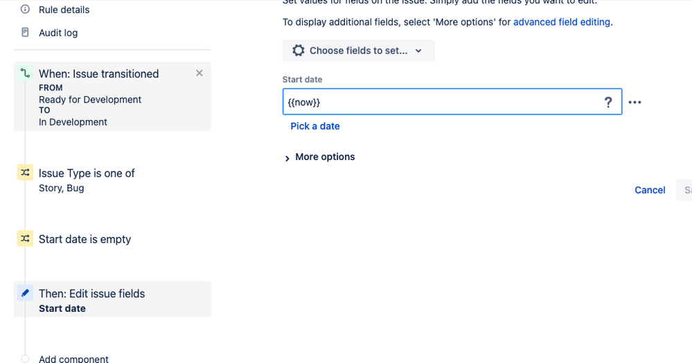

So far, I have the below rule, which adds 'current date' to the 'start date' field as soon as the status for a task = 'In DevelopmentSnip20221006_7.png
My logic here is, if I have a start date stored somewhere, I could then use that as a starting point to pre-populate a value for time tracking.

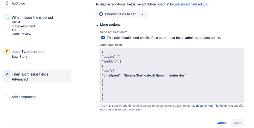

Thus, I've created the following automation rule, where I want the system to look at the 'start date' and calculate the difference between that date and the date of when the task is updated from 'In dev' to 'Code Review'
The automation works, however, I can't seem to get the calculation right with the time logged. I've tried .seconds, .minutes, .days & .hours and I still can't get an accurate reading.

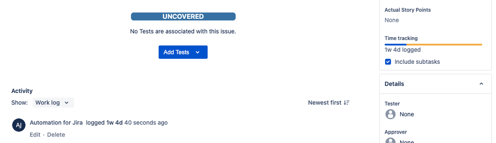

The below example task has a start date of 03/10/2022. The status for the task was changed to 'Code Review' on 06/10/2022, so I would've expected to see 3days logged in the time tracking, however, I instead got the below result.
Any suggestions on what I'm doing wrong here, please?

So perhaps try this in the JSON expression:
"{{issue.Start date.diff(now).minutes}}m"
Allan Vaifale October 6, 2022
Thanking you @Bill Sheboy
I've made your suggested changes but still no luck :/ A lot better than 3minutes from my first trial run though

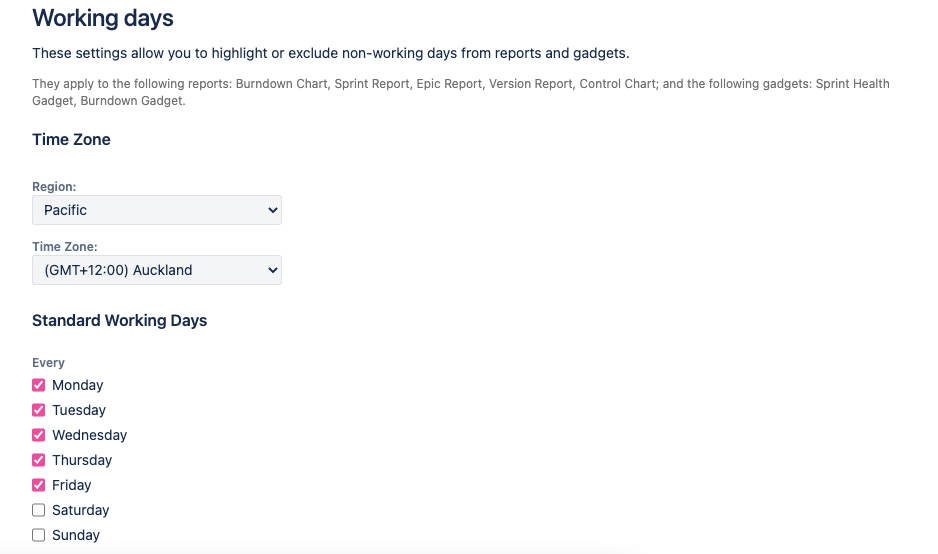

Snip20221007_10.pngSnip20221007_11.pngFor context, our ''ideal day'' equates to 8hrs and the current workday setup looks like the below for this specific project:

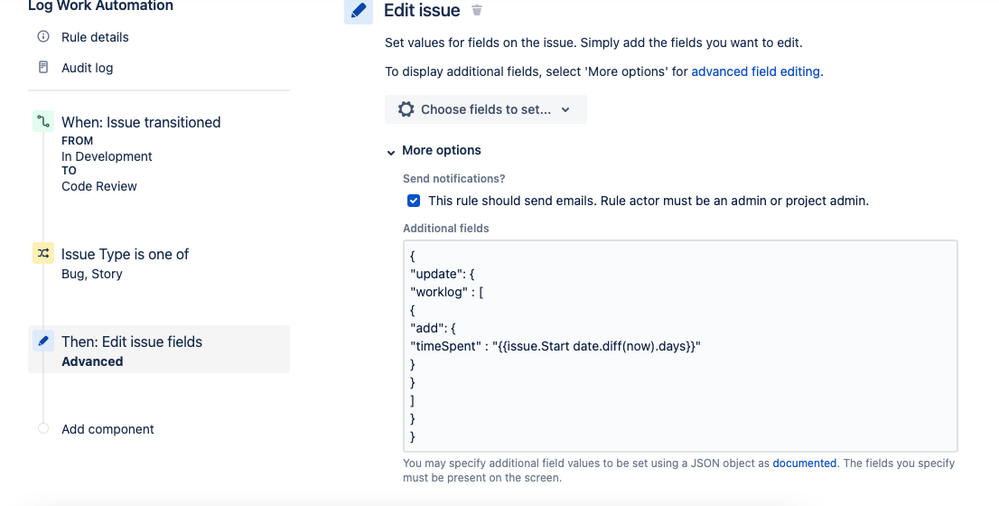

Perfect, it looks like I managed to get it working using "{{issue.Start date.diff(now).days}}d" - Thanking you!
