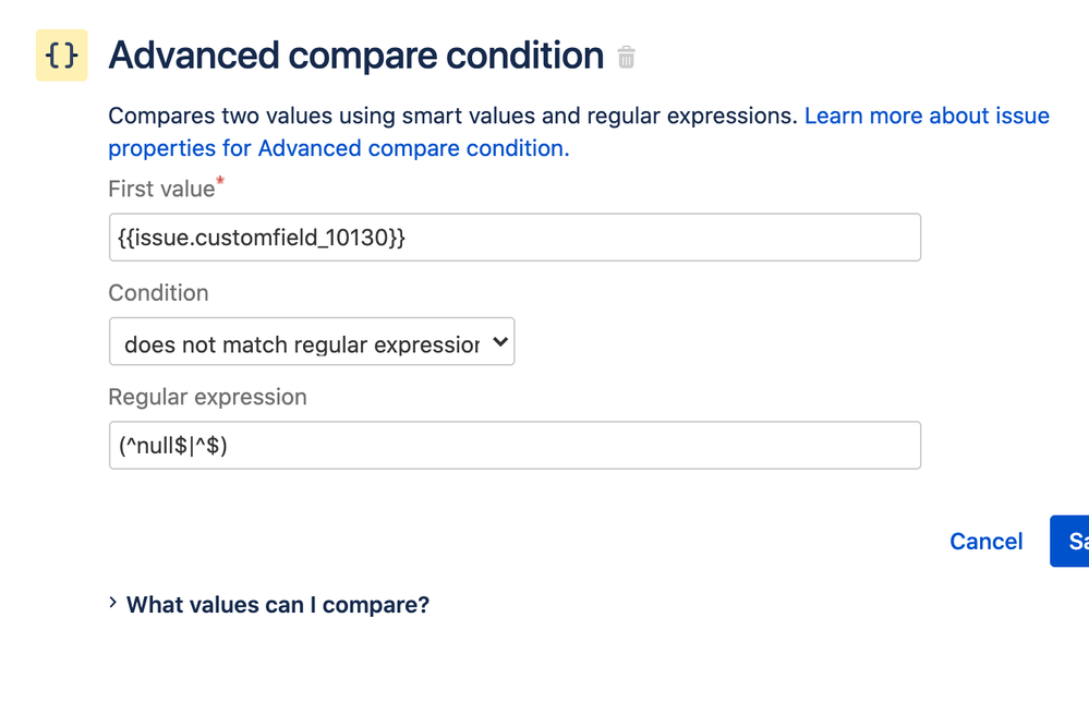

I'm using Advanced compare condition with regular expressions. For the below example I check if a field from the issue's epic is not empty.
For your case would be a similar check

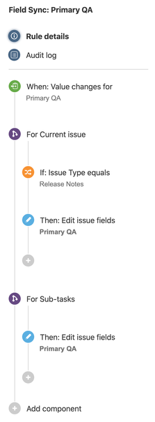

Hi @Hana Kučerová, thanks for the response. I'll try to explain it more thoroughly below.
Just for more context, this is related to another question I posted - trying to understand either situation to come to a solution. The other question is posted here.
I'm demonstrating the behavior in two automation rules - but hoping there is a better way, which combines them into a single rule.
In this project there is a sub-task called "Release Notes". There is also a custom field called "Primary QA" that exists on both the Release Note sub-task, and the parent issue. I would like to make sure that the "Primary QA" value of the parent is always in-sync with the "Primary QA" field in the "Release Notes" sub-task. These are the two scenarios I'm trying to make work.
  1. When the "Primary QA" field is changed in the parent issue, the change is reflected in any existing "Release Notes" sub-tasks. (Currently working with the "Field Sync: Primary QA" automation rule below)
  2. When a "Release Note" sub-task is created for the parent issue, the new sub-task's "Primary QA" matches what is in the parent issue. (Currently working in "Field Sync: Primary QA 2" automation rule. Attempted as the second branch chain in "Field Sync: Primary QA" automation rule).
It seems I can trigger on when a field is changed, or an issue is created, but if I could trigger on both states, then it seems like I could work through the logic in the automation rule.
Any suggestions would be appreciated. Thanks for your time!
