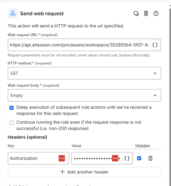

With the first step, there are no conditions; I want the rule to trigger when a hardware asset is created.
Then it creates a variable named Object and pulls the smart value of {{object.key}}.
It then sends the web request, using the GET HTTP method, with an empty web request body.  I have it set to delay the execution of subsequent actions until it gets the response.  For the key, I have my new API token that I created this morning.  As far as encoding it, I'm not sure what would need to be encoded.  I created it using the create API token option and gave it a name and expiration date.
It then creates a new variable named UserName using the smart value {{webResponses.last.body.actor.Name}}.
It then creates a new variable named user using the smart value {{UserName.substringBefore(",")}}.
It is then supposed to send an email to me with the content "Asset {{object.key}} was just created by {{User}}."

Can you share a screen image of the Send Web Request action?

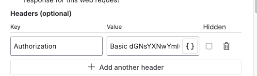

When adding it to the Send Web Request you need to insert this:
...where the "dGNsYXN..." is the long string you got from the encode command. You can then check the Hidden box, but once hidden you cannot re-reveal it, so you'll want to be very sure it is correct.
