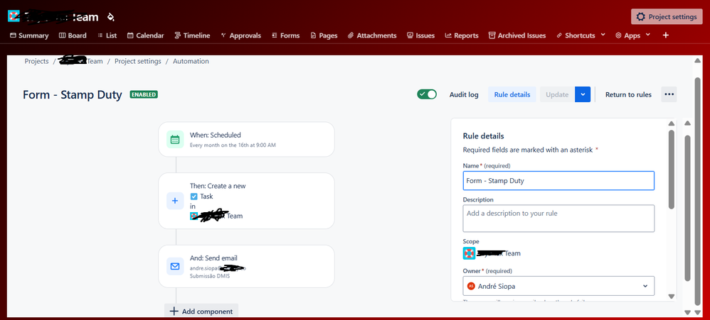

I´m trying to make an automation rule, on xx day of each month I receive an email and want that rule to show on Board + Calendar.

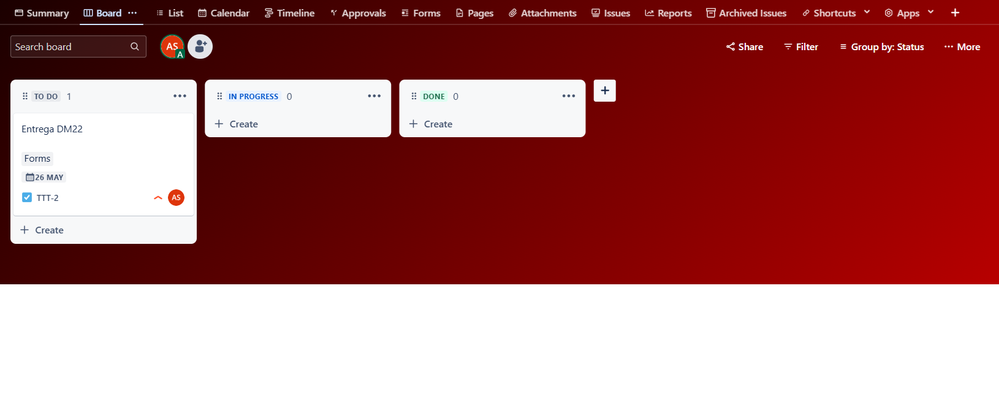

Based on what I find, I created a Schedule, then create a new task and finally the send email (print 1). The problem is that this automation is now showing in the board/calendar (print 2)
I already check, I have no filters and everything is suppose to be "right" so I don´t understand why this is not showing, is there something missing? I have a lot of additional automations to made but want and need to be visible.

Jira boards are a view of issues based upon the board's filter.  Did you ensure your created issue matches the filter so it can display on the board?
Next, there are two additional criteria for displaying issues on the board:
  • For a Scrum board, the issues must be in the sprint.  That does not appear to be the case as you have a Kanban board, correct?
  • What is your project type: company-managed or team-managed?
    • For team-managed projects, issues must be explicitly added to the board from the backlog.  For automation created issues, there is an action to Move Issue to Board for this situation.  Remember to branch to the most-recently-created-issue before that action.

Can you navigate to the View All Projects page under the Projects menu and find your project listed there? When you do, what does it say in the Type column for your project.
If you are working with a Team Managed Business project there is not a Backlog option. All issues in scope of the project will display on the board (within the limitations of the board's functionality).
Based on the screen image you provided, specifically to option shown where it says "Group by: Status", I believe you are using a Business project. That option does not appear for other project types' boards.
My next suggestion is for you to review the information generated in the Audit Log for the rule when it executed. The Audit Log screen is accessed by clicking on the Audit Log link at the top of the rule on the right.
Does the audit log have any entries indicating that the rule executed? If so, expand the entry (click Show More), and click all the right-pointing arrows on the right side to expand all the details. Then provide a screen image of what is displayed.
If an issue was actually created the issue key will be shown within those details.
You have specified that the rule run on the 16th of each month. We have not reached the 16th of March yet. Did you run this rule manually?

Thanks for that information.  As this is for a team-managed project, you cannot change the filter...which makes a rule like this simpler, although the Move Issue action is still needed to add to the board.
  • trigger: scheduled
  • action: create issue, for the new Task
  • branch: to most recently created issue
    • action: move issue, selecting your board
    • action: send email

I just run a test and now everything is working perfectly. Maybe it´s my lack of experience with Jira but I thought when I make an automation that will immediately shows on the Board/list/calendar, but it seems only after the trigger event that task will show there.

As I mentioned in my addition to @Bill Sheboy 's answer, if you are using a Business type of project there is not a Backlog screen so there is no need to move the issue to the board. In Business projects all issues display on the board, within the limitations of the functionality of Business project boards.
As you discovered, the rule does not run if the Trigger event does not occur. Since your rule is set to run on a schedule, it would only execute based on that schedule. No issues would be created until the scheduled date/time occurs. That aligns with my suggestion to check the Audit Log to confirm that the rule had actually executed.

"Hi Trudy Thanks for the welcomes and the help. Please see below my answers: Can you navigate to the View All Projects page under the Projects menu and find your project listed there? When you do, what does it say in the Type column for your project. Is a team-managed Business, so you it seems there is not a Backlog option You have specified that the rule run on the 16th of each month. We have not reached the 16th of March yet. Did you run this rule manually? I just run a test and now everything is working perfectly. Maybe it´s my lack of experience with Jira but I thought when I make an automation that will immediately shows on the Board/list/calendar, but it seems only after the trigger event that task will show there. Is there a way to make an automation first and immediately shows on board?"
My reply for your latest question: It seems that is the case, i.e., the automation only shows on the board after is executed, until there will always be in the automation, so we need to do manually, first include in the Board all events and then create a rule to receive notifications.

Please describe what you want the automation to do, and when you want those events to happen.
The automation you have shown in the images is designed to create an issue on the 16th of each month and send an email. Because you have used a Schedule trigger, those events will happen only as you have specified in the Schedule - on the 16th of each month.
An issue will show on the board and in the calendar in a Business project only if the issue exists. The issue doesn't exist until it is created.
If having the issue created on the 16th of the month and then appearing on the board on that same day is not fulfilling your requirement, please describe your requirement in more detail.
