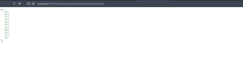

You'll notice that I have used this header:-
final def headers = ['Authorization': "Basic ${"${username}:${password}".bytes.encodeBase64()}", 'Accept': 'application/json'] as Map
and I have set the header to the RESTClient, i.e.
def http = new RESTClient(hostUrl)
http.setHeaders(headers)
This will implicitly add the authentication details to the REST Endpoint. Hence, when I try even to invoke the REST Endpoint, I can invoke it as:-
http://localhost:9091/rest/scriptrunner/latest/custom/getVersions
without any need for a username or password, and I can get the expected results as shown below:-

As you notice in the example above, instead of setting the username and password on the REST Endpoint, I am passing them as query parameters instead, i.e.:-
def username = queryParams.getFirst('username')
def password = queryParams.getFirst('password')
Hence, when I invoke the REST Endpoint on the ScriptRunner Console or Automation script, I will need to use:-
def hostUrl = "${baseUrl}/rest/scriptrunner/latest/custom/getVersions?username=${username}&password=${password}"
