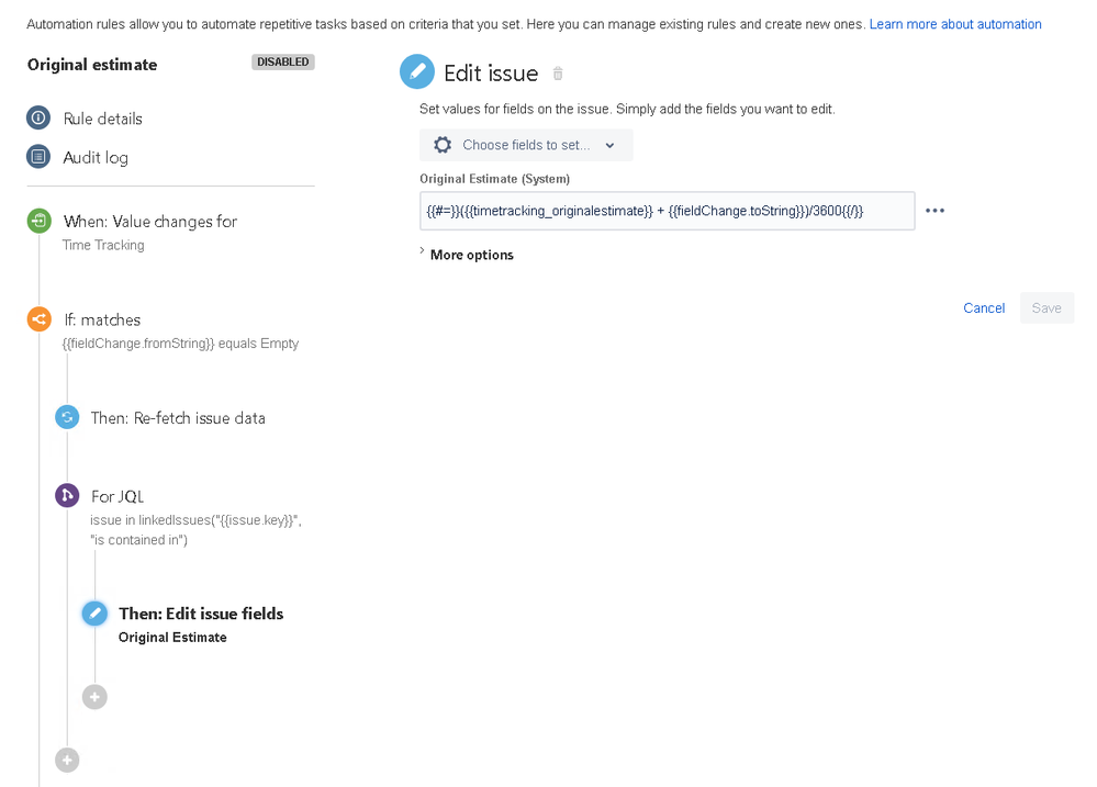

So, what we managed to get so far is this calculation for Original Estimate by using Time Tracking trigger and {{fieldChange.to/fromString}} smart value. This smart value always gets values for Original Estimate and we got stuck on how to get Remaining Estimate from it.

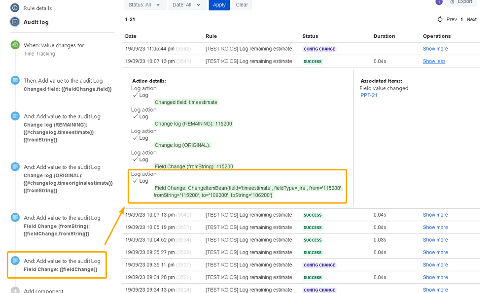

I was just working around with those (mostly with {{fieldChange}} smart value and actually I managed to get the result.

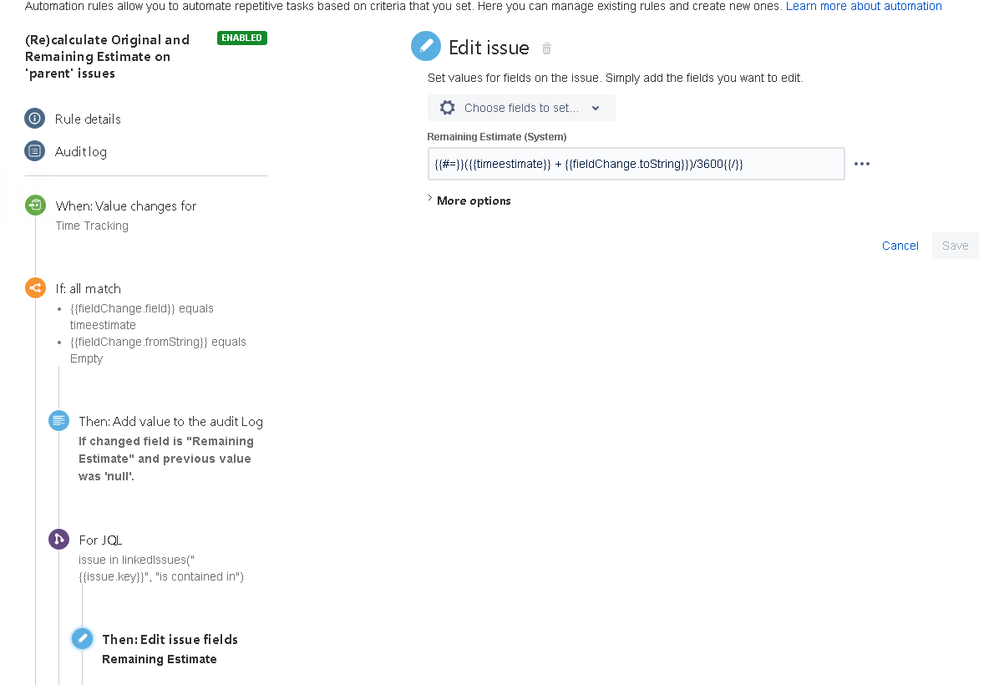

Firstly I've checked what {{fieldChange}} smart value returns and inside the results, you can check which field was changed. Regarding Time Tracking trigger, it can be either timeestime (which is Remaining Estimate) or timeoriginalestimate (which is Original Estimate).
Based on that, you can get appropriate values by using {{fieldChange}}{{toString}} or {{fieldChange}}{fromString}} and these can be manipulated later in the rule by using standard/math expressions.
So, I've added few If/Else blocks that have conditions based on mentioned smart values (depending if we're looking at change on Original or Remaining Estimate) and then just added an action that does a specific calculation.
In any case, I just needed to log {{fieldChange}} smart value first to see what I could do with the provided results.
Additional note after latest tests - {{fieldChange}}{{fromString}} would, for example, get previous/old value from one of those fields. This way of implementation works only if one of the fields is changed/updated. If both fields are updated at the same time (e.g., via Edit screen), you could, potentially, use something like this:
This should also cover the case if both field values are updated at the same time (although I would probably need to test it out properly).
