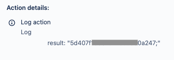

To help troubleshoot rules, I always like to use the "Audit log" action - in this case to see what your lookupissues smart value expression evaluates to.
In my test, it looks like this:
I'm guessing that's not quite what you expected (it's not an email address). It's actually the user ID, which is what Atlassian uses to identify users.

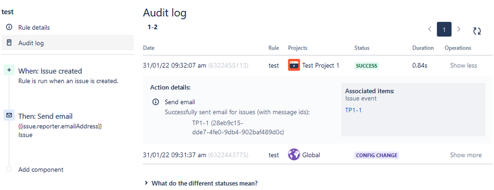

Mykenna, did you try to actually send the emails? I just tested and it failed for me too:
It appears there is a problem with Send Email and use of smart values which are not in one issue.

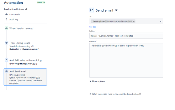

These are the steps I have. It's not a complex automation by any means
@Tim FosterThanks! I'll let you know if I can get something working.
Hi @Tim Foster
Did you note you have some square brackets, not curly ones in your smart values in the image? The smart values should only use curly brackets.

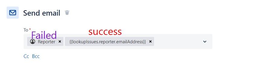

Hi @Tim Foster ,
You can try this,
{{lookupIssues.reporter.emailAddress}}

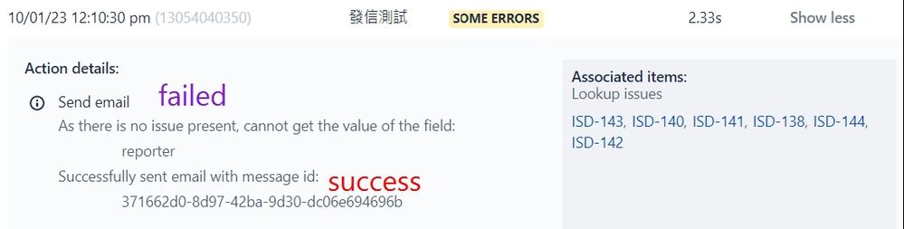

I success to do this,It will sent email to reporters!
Hi @Ivanna -- Welcome to the Atlassian Community!
Context is important for automation rules, so I suspect the reason your reference to just Reporter failed is there is no issue at that rule scope.
If you believe it is something else, please create a new question (rather than adding to this one), posting images of your rule and the complete audit log details of the rule run for context.
