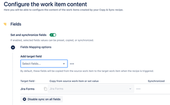

To copy your issues from JSM to Jira including their forms, I can suggest trying our app Elements Copy & Sync.
Don't hesitate to check the documentation, it’s really quick and easy to set up.
The app is for free during 30 days (and it stays free under 10 users)
