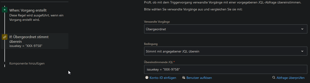

Did you try it like this?
I used the condition for related issues and checked the issuekey of the parent issue. That should work out.
erin_fowler January 10, 2022
Any chance you can repost this in English:)
