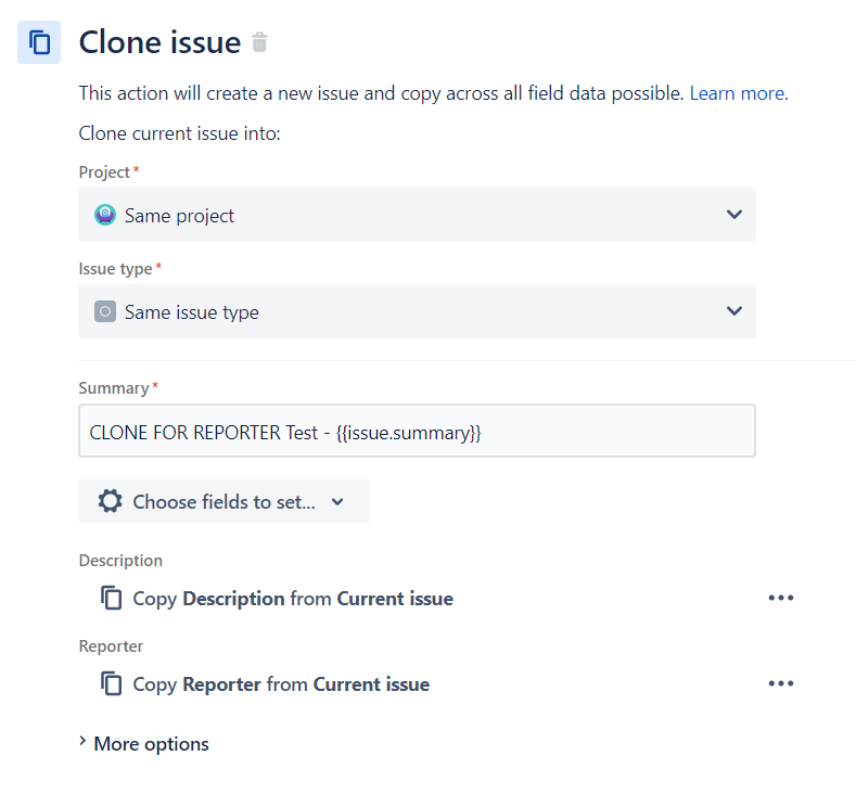

Can do!  Here is what I did:
  • Selected the clone action
  • Selected the fields I wanted
  • Selected the reporter field, selecting the ... at the right of the field and the option to copy from current issue
Bruce Robinson June 16, 2021
Ahh ok, thanks so much @Bill Sheboy! Unfortunately, this hasn't worked for me. I'm assuming it's because I'm not cloning in the "Same Project," but rather, I'm choosing a different project (original issue in "PF" and cloned issue in "PF1"). I think that's why I'm banging my head against a wall...same users with the same access and permissions to both projects, same field configurations, same screen configurations, yet I cannot get it to work. Thanks so much for your help, regardless! I'm just assuming at this point it's just not possible to do across projects with Jira Automation, at least at this time.
