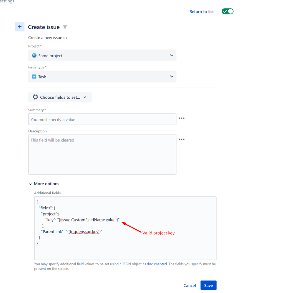

I think people are not seeing that this question has been answered, so I am re-posting @Italo _Modus Create_ 's answer as an answer outside of the the other answers thread, because I found that this answer does in fact work!
@Italo _Modus Create_ said:
I was able to achieve this by using the additional fields to overwrite the Project that I need to create the issue.
In my case I have a custom field named "Activity" and the options are
  • Task A - ASP
  • Task B - DSP
The bold section is the project that the task should be created into, so I was able to do extract the project key using substringAfter and then use to as the project key.
"fields": {
"project":{
"key": "{{issue.Activity.value.substringAfter("-").trim()}}"
"Parent link": "{{triggerissue.key}}"
 Hope this helps people find the answer! This was a big unlock for me!

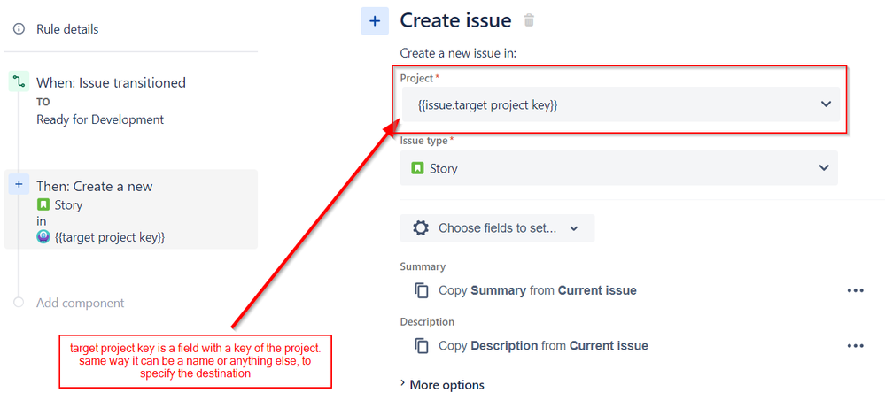

Alex Rouk
October 1, 2020
@Simmo , i can definitely share anything :) but I am not sure what can i share..
attached a dummy rule that covers my need.. hope it helps..
thank you again for the time and willingness to help. much appreciated!

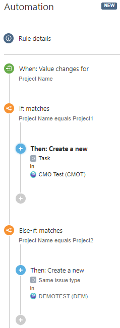

If you only have a few projects it would be easier to have a select field with project names. The automation would trigger based on that field change>IF/Else Block for each field value, then add the action to create issue for each field condition. The example below would create a Task in (CMOT) if Project Name = Project1, or Task in (DEM) if Project Name = Project2.
Like • Thierry BLOCH likes this
September 27, 2022
  • Task A - ASP
  • Task B - DSP
"fields": {
"project":{
