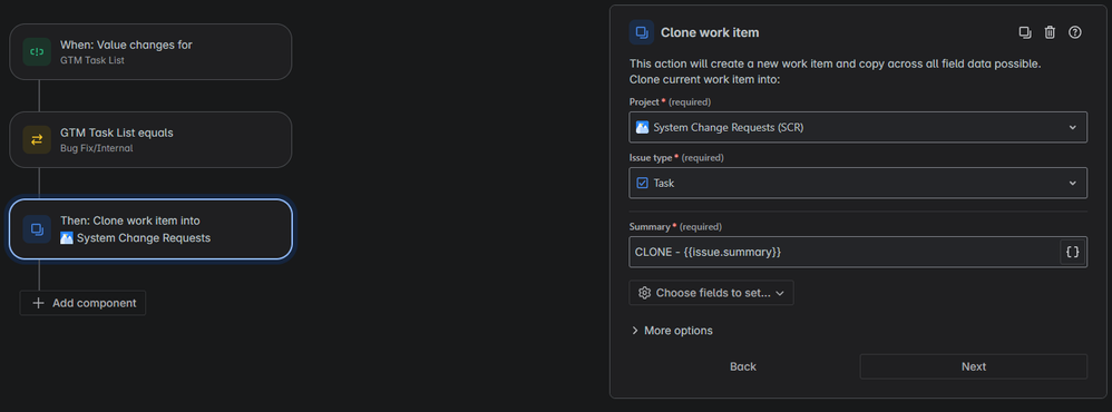

I get stuck on the last part as if I select this option from the drop down, then I want it to clone case SCR-23300, and link it
The rule you have is going to clone the issue where the GTM Task List field was changed. Did you change that field on SCR-23300? Or are you triggering this rule from some other issue, but want SCR-23300 to be the issue cloned regardless?
The Epic has this custom field (GTM Task List), I want a clone of SCR-23300 to be linked within this Epic when they select "Bug Fix/Internal" (eventually I will do this with the other fields here with a different SCR)
Okay, that's different. Maybe try adding a branch with JQL for key = SCR=2330. Then under the branch an action to clone the issue. Then in the Clone action set the Parent field = trigger issue.
Just doing this off the top of my head, so it might not work as intended.

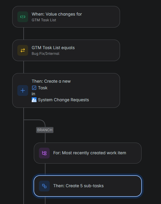

John - I decided to move away from cloning a specific work item, to just simply creating it and adding sub-tasks.
So what is not working? Make sure that you have both projects in the Rule details and not just a single project for the trigger issue.
This works, and team is happy with result. Thanks for all the assistance!
