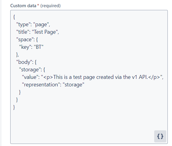

Specifics of "Send web request:"
Below are screenshots of the action.
I do know the URL posted in the screenshot is going to be deprecated in 2025. When the rule is actived, this URL leads to this error:
Unable to publish the web request - received HTTP status response:
403
Error found in the HTTP body response:
{"message":"current user not permitted to use Confluence","statusCode":403}
When I use the URL for Confluence Rest API 2.0:
https://domain.atlassian.net/wiki/rest/api/v2/pages
I receive this error:
404
{"message":"null for uri" https://domain.atlassian.net/wiki/rest/api/pages/","statusCode":404
