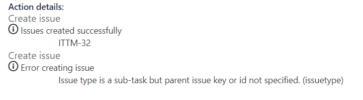

However when run, it shows the below output including an error at the subtask step:
Action details:
Create issue
Issues created successfully
TEST-32
Create issue
Error creating issue
Issue type is a sub-task but parent issue key or id not specified. (issuetype)
Please advise what the problem is here?

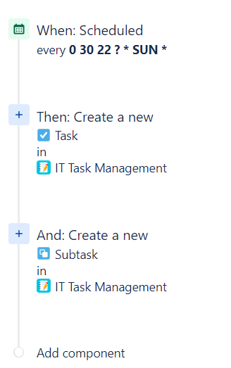

Here is a snip of what I'm trying to achieve - it begins off a scheduled time trigger:
Based on the above, would there still need to be conditions added?

Adam Foot December 20, 2020
Hi @Ash Pitt I'm unfortunately still getting the error when running the very basic automation shown in my previous post. The error details are below:
Capture3.PNG Any ideas?

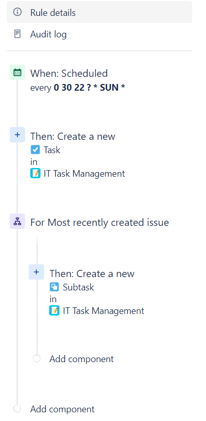

Ash Pitt
December 20, 2020 edited

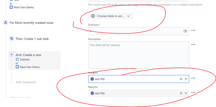

Ok so with scheduling I think you will need to use the branch rule function.
In my example below I wanted to have a task created with sub tasks every day, so I set it up similar to what you did, however used the branching rule for the most recently created issue (which is that task) to create 2 sub tasks.
I think that will sort you out :)
Like • 2 people like this
Adam Foot December 21, 2020
Thanks @Ash Pitt that worked!

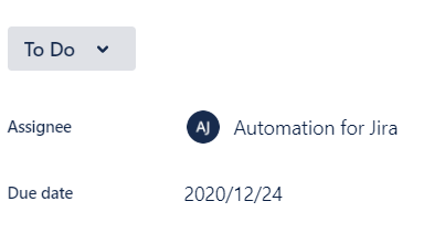

Lastly, even though the Assignee is specified in the rules for both the Task & Subtask, it's still making "Automation for Jira" the Assignee.
Any ideas on how to solve that one?
Ash Pitt
December 21, 2020
Yep I have ideas :)
Within the task/sub task settings you can choose the fields to set, so in that case I chose the assignee and the reporter (though it should work for whatever fields you have set up the require an assignee) - then you just specify who you want it to be assigned to.
Works a treat for me.

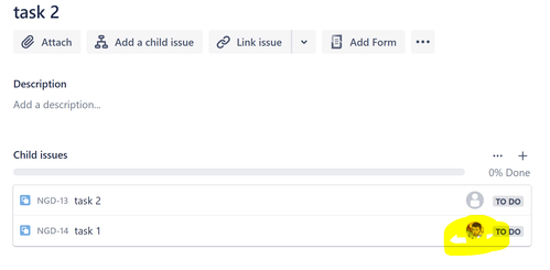

Adam Foot December 22, 2020
Hi @Ash Pitt that's a different result from what I get.
I have it set the same, for the assignee to be x user during the create a new Task & Subtask. However it ends up being "Automation for Jira" as shown below:
I did notice that the Actor is Automation for Jira under Rule Details, but I assumed this is still achievable without changing that:
actor.PNG What do you think?

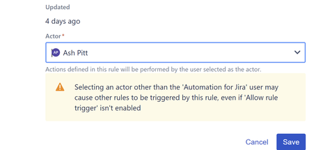

Ash Pitt
December 25, 2020
Merry Christmas @Adam Foot
Changing the actor I think works, however there is caution to be taken with that as well.
However it does work :) note the NGD-50 is the one i set up as me being the actor.
actor2.PNG Hopefully that (now) has helped you get cracking with automation!

Adam Foot December 28, 2020
Hi @Ash Pitt , even though the assignee is set to be user_b, it's making the assignee for both the tasks & subtasks whoever the "actor" is in the automation e.g. if I change the actor to myself, it makes me the assignee for all tasks & subtasks in the automation. If I change the actor to Automation for Jira, then that becomes the assignee.
This is despite the assignee being specifically set in each rule of the automation e.g. create subtask & set the assignee to be user_b.
Any ideas?

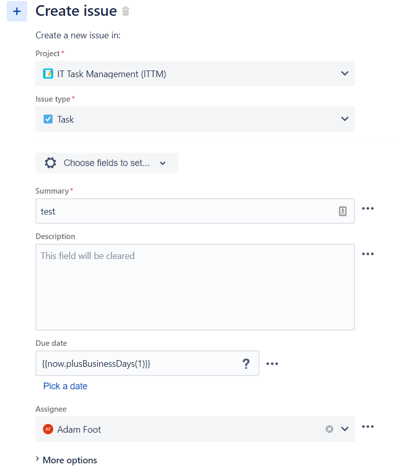

Adam Foot December 29, 2020 edited
As suggested, here are some screenshots of the automation:
Results in the assignee being Automation for Jira:
Bill Sheboy
December 30, 2020 edited
Yup, that looks like a defect.  When you look at the individual task's history does it show as only assigned once to the automation user?
I looked in the public backlogs and didn't see a defect for this, so if you are on a paid license I suggest submitting a defect for this, and then post back here what you learn from the support team:
https://support.atlassian.com/contact/#/
Like • Ash Pitt likes this
Adam Foot January 3, 2021
Thanks Bill, the assignee was just caused by a Workflow issue.
