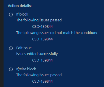

This is what the rule looked like:
This is what the execution looked like:

It appears there is some image capture issue with your rule.  Regardless...the rule image you show does not match the text description of your rule:
  • the image shows two tests on the Initiator in the first if/else block
  • but the text description shows one test on Initiator and one on the custom field
I wonder if there was a problem with the initial rule conditions.
Tom De Blende
October 4, 2023
Hi Bill,
I was wrong. Explaining the whole logic to you and diving deeper into it helped a lot in finding my error :)
The first If block was not hit, because a new condition was added. And because it was not hit, the Else-if was hit, while it shouldn't have been.
Thanks a lot for your time!
