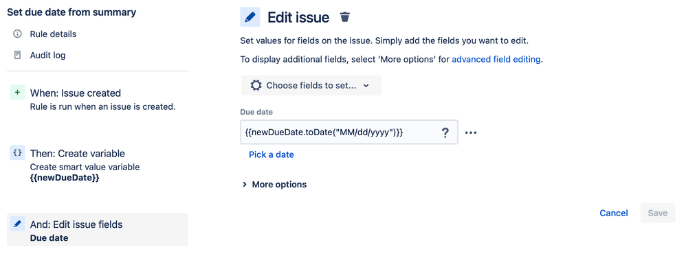

Hi @Thomas G,
The following automation rule should meet your needs:
Here are the details of the Create variable action:
You can copy the smart value below:
{{issue.summary.match("(\d{1,4}([.\-/])\d{1,2}([.\-/])\d{1,4})")}}
Here are the details of the Edit issue action:
{{newDueDate.toDate("MM/dd/yyyy")}}
Let me know if this works on your side too!
- Manon

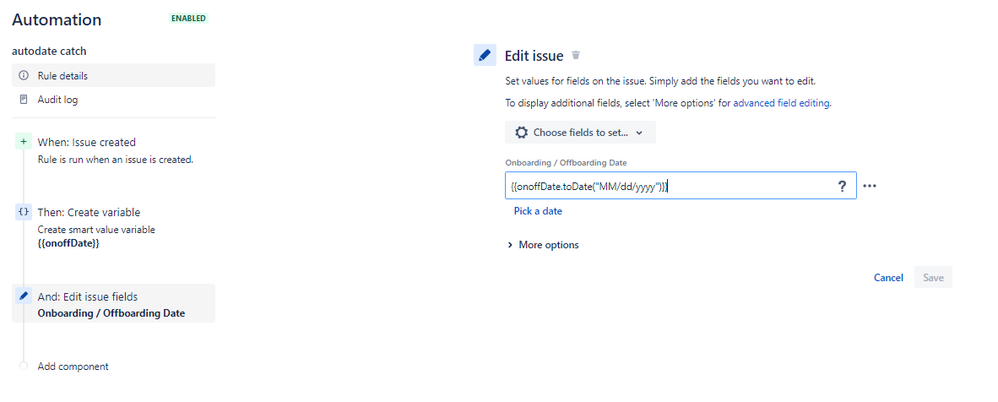

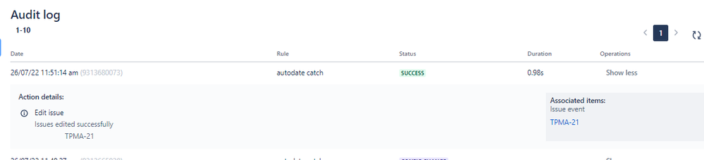

qi.ming July 25, 2022
@Manon Soubies-Camy
hi Manon,
I have the same issue here that I need to parse the date from the issue summary (example:onboarding Huniya Akbar (iCC UK, 31.07.2022)) then put it to the Onboarding / Offboarding Date field we have, I had checked your solution and Thomas's too, the syntax should definitely work for me too but unfortunately it didn't, there is no value for the field after the automation has been applied. any idea why?
Gomez, Daniel
October 18, 2023
you used on / off in the variable, you have to use the whole name onboarding/OffboardingDate
