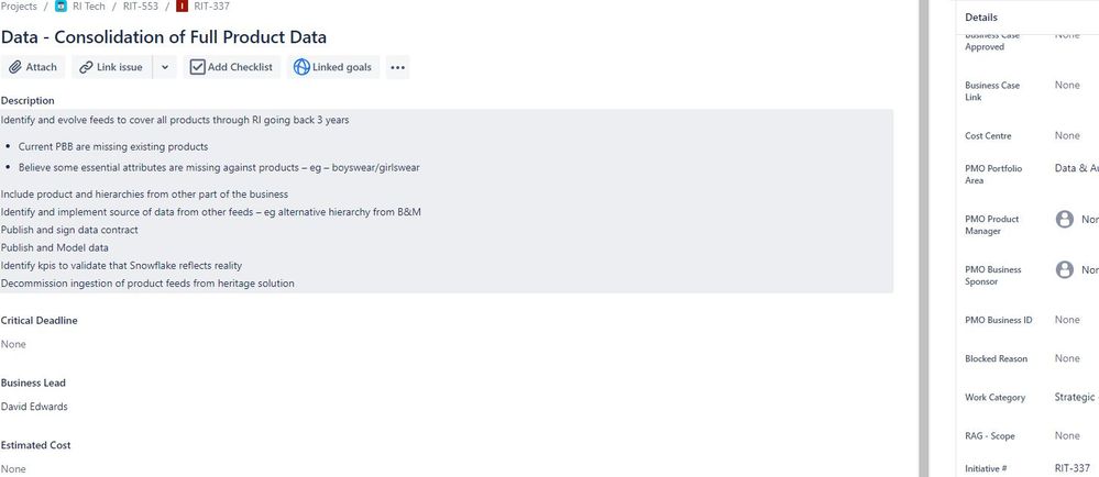

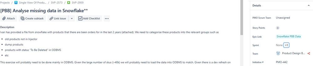

I want to create an Automation rule in which all the issues which has the Parent (Initiative issuetype) Initiative# field value should make the child (Epic, Story issuetype) Initiative# field value same especially the ones which are wrong. So for example in the below snip the Parent has the correct value but the child doesn't show the right value. So it should be RIT-337 but Epic & Story is showing PMO-442

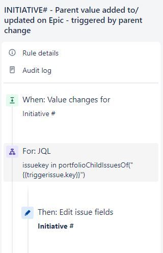

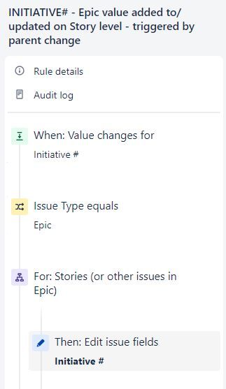

So what I can see is that there is an Automation which did the trigger on June 17 from Blank to PMO-442 for Child issues and Parent one happened last month by Automation as well from PMO-442 to RIT-337. I have added the snip below for the 2 automations currently exists

You show two rules, and now I wonder what is not working as you expect?
Synchronizing a field across this many issue type levels can require either several rules (to update as changes occur), or a single, scheduled trigger rule to do this periodically (e.g., daily).
