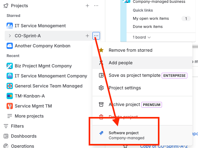

Do you have any third party apps added to your Jira instance that would extend the workflow capabilities, like Jira Workflow Toolbox, ScriptRunner, or Jira Miscellaneous Workflow Extensions?
Also, what is your project Type. Get that information by clicking on the three dots next to the project name in the navigation panel on the left.
