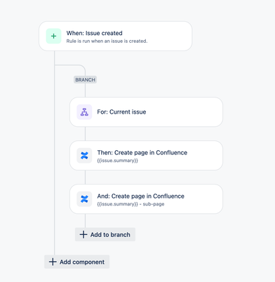

Hello @Bernd Anderer
You can test this automation rule, where a page in first action is being created based on the summary of the issue, the second action is creating a sub-page and in the "Parent page" field, the page that was made from the first automation is being selected.
