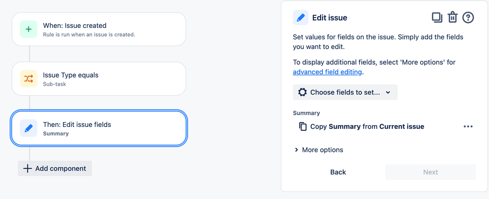

Tharaka_Hettiarachchi
April 29, 2024
Hi @ramnik malik ,
You can use Jira Automation to do that.
1. Go to Project Settings -> Automation -> Create a rule
2. The rule should triggered when 'Issue Created'
3. IF/Else to check its a sub task
4. Then 'Edit issue'
You can select the fields you want to update and tap on 3 dots-> select 'Copy' option
