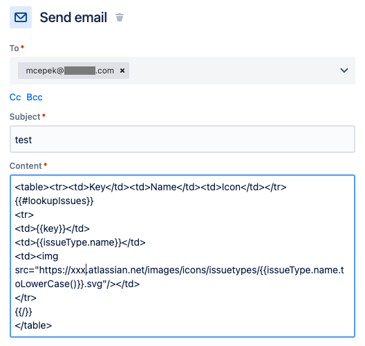

Based on this, I created a test rule which replicated part of your table:
This simply maps {{issueType.name}} to all lowercase letters and embeds it in the URL for the icon. Here's a text version of that magic line above (for easier copy/paste):
<td><img src="https://xxxx.atlassian.net/images/icons/issuetypes/{{issueType.name.toLowerCase()}}.svg"/></td>

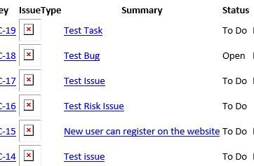

<td><img src="https://myjira.com:8080/images/icons/issuetypes/{{issueType.name.toLowerCase()}}.svg"/></td>

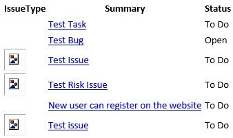

it didn't display the icons. It displays image missing icons, here is the screenshot:

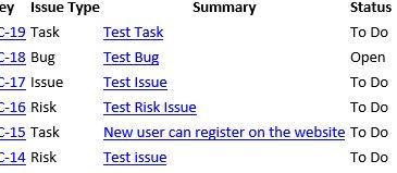

I did right click and selected "Download Pictures" from outlook, it still didn't display icons. it displayed the below icons:
