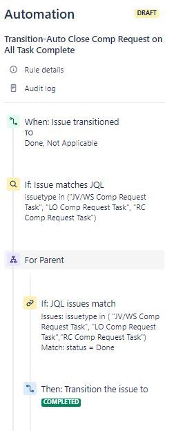

I have a standard issue type of "LO comp agreement change request" which is the parent of the issue type "LO comp request task". They are linked using the parent link field from the roadmaps app, not the standard default jira linking functionality. What am i doing wrong here. I want the parent issue to close automatically when all child issues are marked and done or not applicable.

Scott Federman March 2, 2022
@Bill Sheboy yes of course. It says no links because i used the parent link field. audit log.JPG

Hmmm...if that branch type does not work due to the linking, please try a branch on JQL to get at the parent.  You can test that JQL first with advanced search and once you have what you want, use it in the branch.
And...you do not show the details of your second "JQL issues match" condition to check for remaining items as "done" or "not applicable".  Please review that to ensure it does what you expect...and if not, instead consider using Lookup Issues and check the size to confirm there are no remaining child issues.

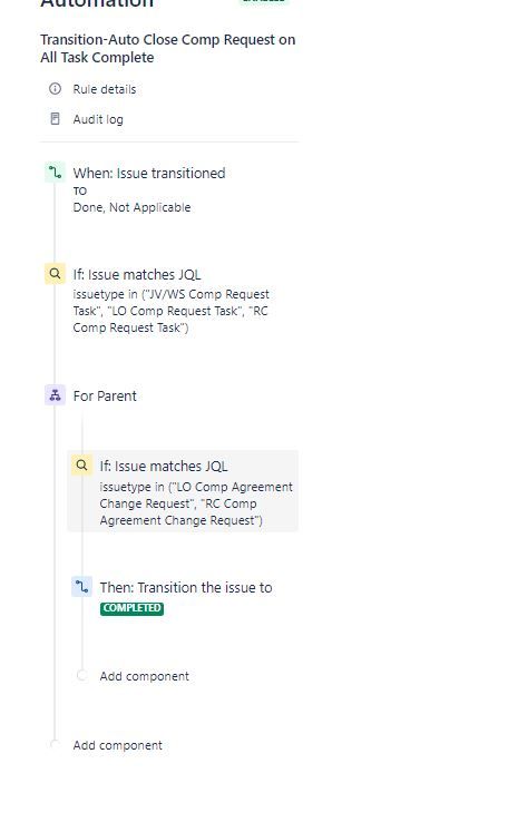

@Stefan Salzl @Bill Sheboy
I am able to get it to transition the parent with this automation when one child ticket closes but i cant seem to get it to hold off until all are closed.
Bill Sheboy
March 2, 2022
Correct; that is why I suggested replacing your second JQL condition with a Lookup Issues action with JQL to check for any sibling issues (same parent) and which are not done/completed.
Then use an advanced compare condition and only proceed if the following value is zero: {{lookupIssues.size}0}}

Hi @Scott Federman ,
Is that by purpose that your JQL (especially the issue types) are the same in your condition for the trigger as well as for your parent branch??
As described in your initial question "LO comp agreement change request" is the parent. As this issue type is not part of the JQL condition in the parent branch it cannot find a match.
