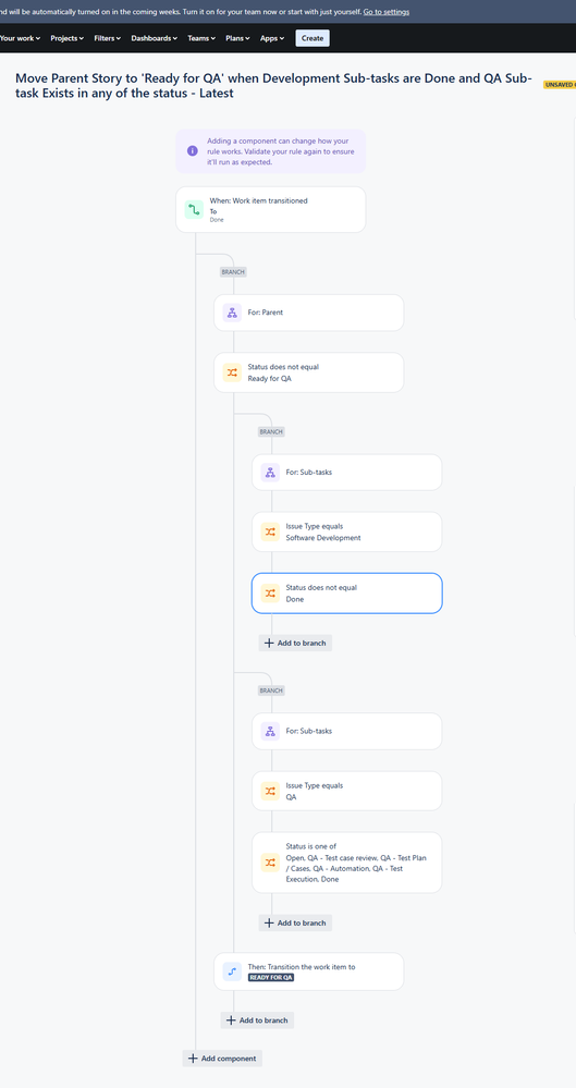

I want to stop the JIRA rule execution if the condition is not met. But I did not find the trigger action as a stop rule execution. Can you help me?

Hi @Ashish Nayak
Something is curious about the rule image you show: there is no such feature as nested branches in Jira Cloud, Server, or Data Center at this time, but your image shows nested branching.
There was a defect that allowed dragging a branch inside of another one while editing a rule, and that produced undefined / unpredictable behavior until it was fixed (for Jira Cloud).
Please explain how you created that rule, and if it is indeed an Atlassian Automation rule image.

Ashish Nayak April 25, 2025
Hi @Trudy Claspill ,
Thank you for the response. I create rule for the below condition,
Move Parent Story to 'Ready for QA' when all the Development Sub-tasks are Done and QA Sub-task Exists in any of the status.
Please find the attached screenshot for reference.

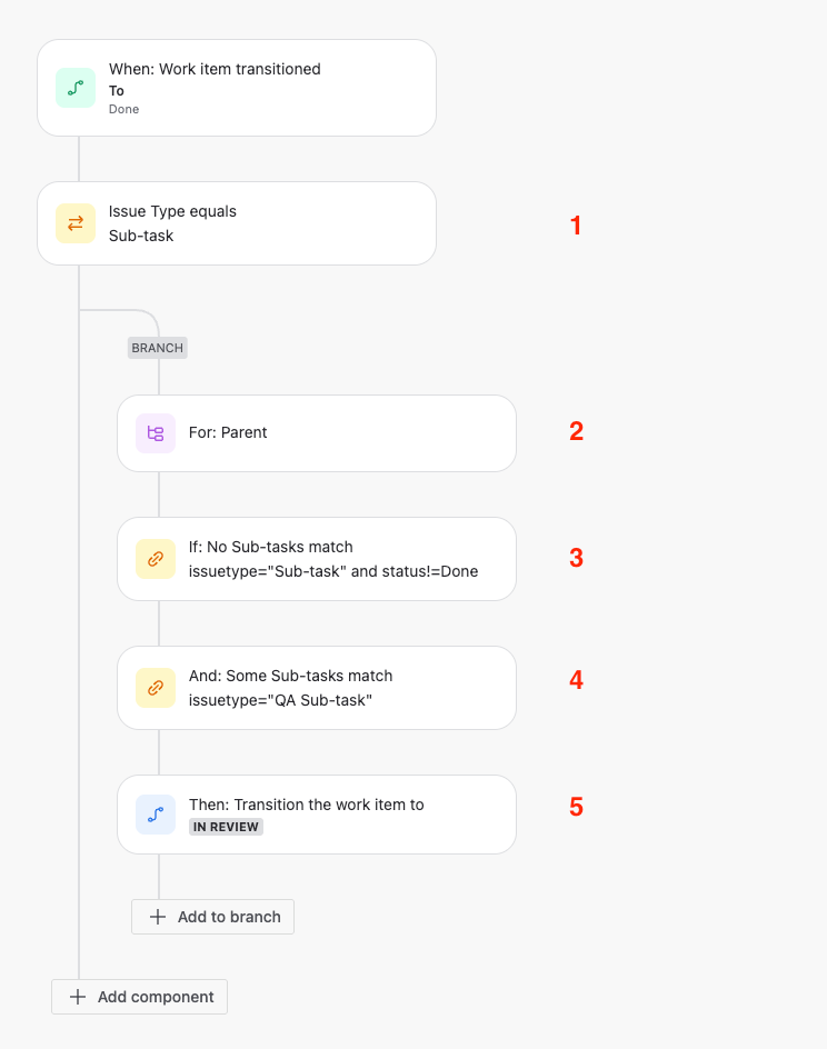

Trudy Claspill
April 25, 2025
I believe this is the rule you need:
  1. First confirm that the issue triggering the rule was a Dev Sub-task.
  2. Branch to the sub-task's parent
  3. This will confirm that there are not any Dev Sub-tasks set to any status other than Done
  4. This will confirm that there are some QA Sub-tasks under this parent issue.
  5. If both 3 and 4 are true, then transition the parent issue to the desired status.
If either 1, 3, or 4 are not true, then none of the steps that come after the not-true condition will execute and the Parent issue status will not be changed.
