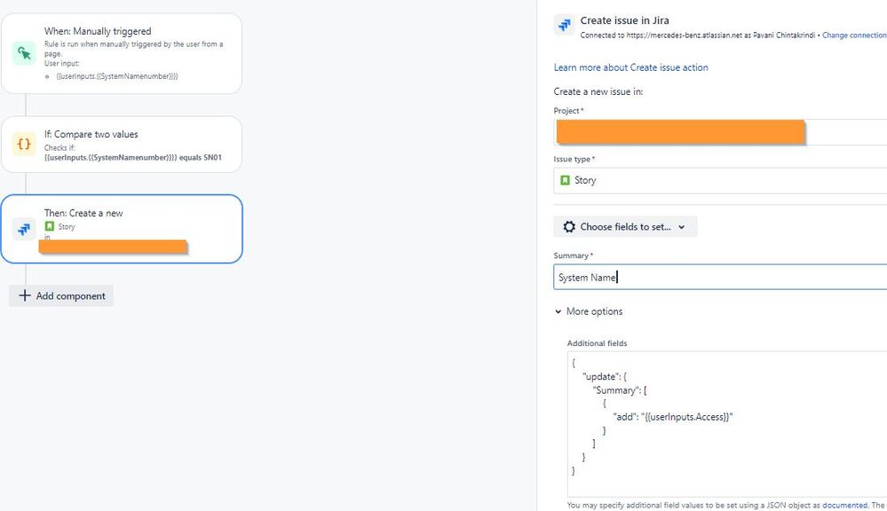

How to compare {{userInputs}} with the selected input value in confluence automation
Pavani Chintakrindi February 7, 2024
I have to compare the input which is selected with the specific and create the jira issue accordingly.000102.jpg000101.jpg000100.jpg000099.jpg

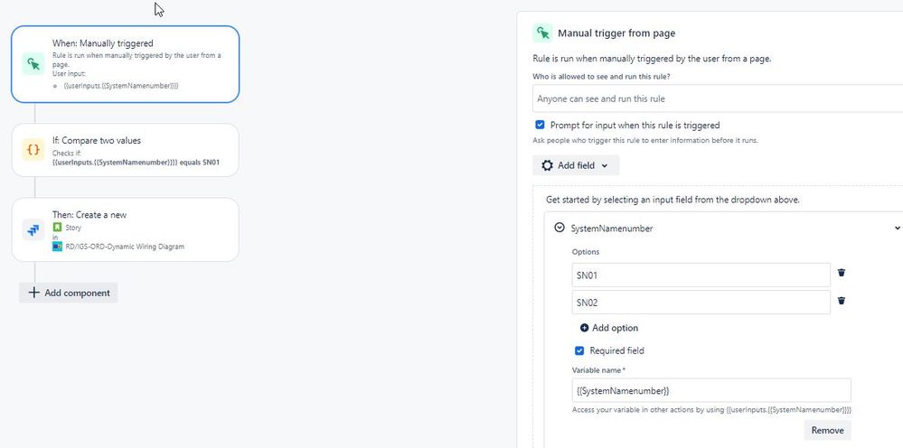

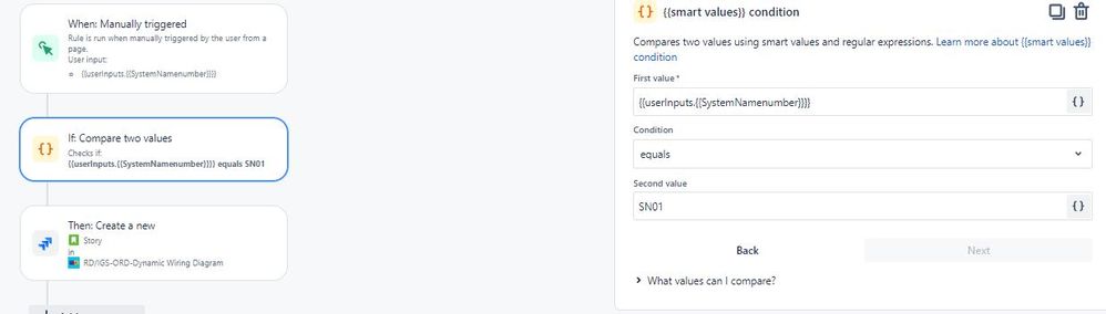

There should only be one set of double-curly brackets around the smart values in an expression.  And it appears in your Manual Trigger's user inputs that you entered a variable name of:
{{SystemNamenumber}}
When naming a variable, do not include the double-curly brackets.  Instead use just the name:
SystemNamenumber
Later in the rule, when using the smart value, it is referred to as this:
{{userInputs.SystemNamenumber}}
Bill
Pavani Chintakrindi February 13, 2024
Thanks alot it's working now.
